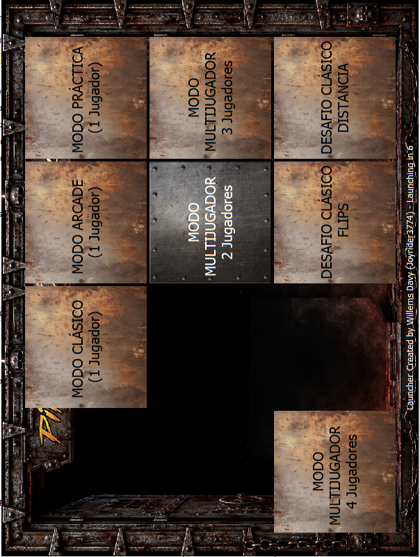

I know I'm a pain, but I downloaded pinballfxluanch.zip again, starting from scratch, but it always gives me the same problem. It loads fine, and I get a player selection screen, but whatever I select, I get this attached screen.
I desperately ask for your help because no matter how many times I modify -hotseat_2 or 3 or 4, the same thing always happens to me. I don't know if I have the wrong .ini for the launch or the pinball M configuration.
