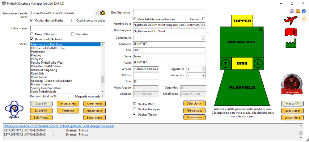

The Future Pinball black screen issue IS fixed. The issue of launching FP from PinballX IS fixed, although it takes a long time (video attached) https://youtu.be/Oh2QheAgrUI I was really looking forward to having the Pinball Horror system with the VPX and FP tables, but no matter how much I try, I can't seem to get it working. I know I'm doing something wrong, but I've looked and looked and I can't find the problem. -

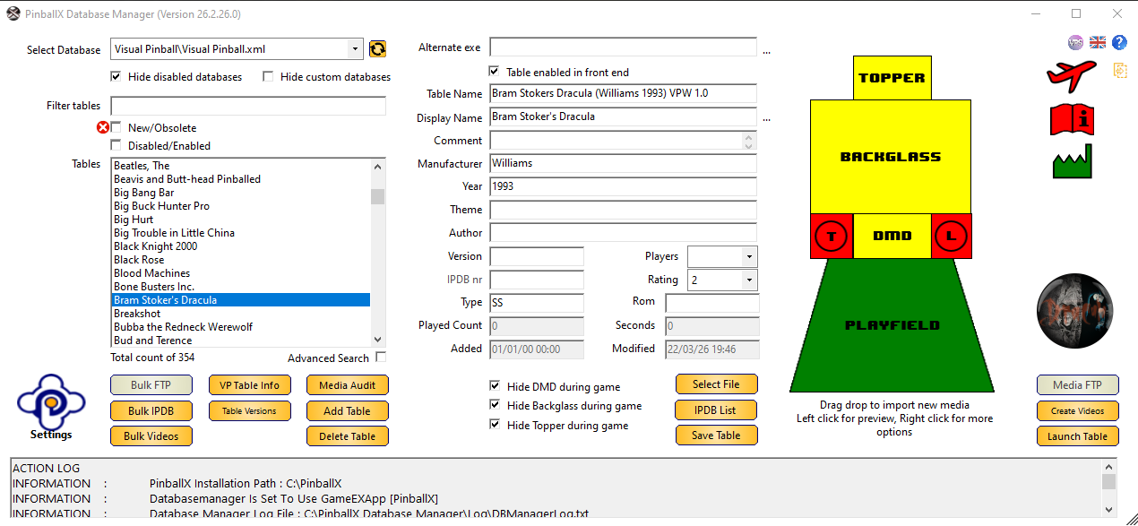

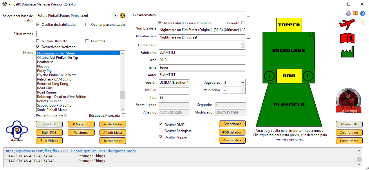

Yes, Future Pinball works outside of PinballX. But I can't put a Horror Pinball horror.ini file in VPX and Future Pinball. Yes, Future Pinball works outside of PinballX. Yes, Future Pinball works outside of PinballX. But I can't add a Horror Pinball horror.ini file to both VPX and Future Pinball. I've included a video that you'll see better than images. It also shows that with the Horror.ini file and Data Manager 26.2.26.0, it says I can't have two horror.ini files. https://drive.google.com/file/d/1Wh5kzJ0BWvJIGwStyWIE0Kbn-uCEuQ9c/view?usp=drive_link -

I'll try to explain, I hope I can do it without making it too complicated. I hope I'm explaining myself well; this is difficult for me, to be honest, I'm not that advanced anymore. I've checked everything, and yes, VisualPinball was missing "All systems," which I've already enabled, but it's still not working. All the Visual Pinball tables open; the only ones that don't work are the Futura Pinball tables, which give an error shown in image 5. I honestly don't understand, but I'd say the problem stems from the "horror pinball" system I've set up: System type: custom Working path: C:\vPinball\VisualPinball Table path: C:\vPinball\VisualPinball\Tables (Of course, this includes the VisualPinball tables, but not the Future Pinball ones) Executable: VPinballX64.exe Parameters: /play -"[TABLEPATH]\[TABLEFILE]" So far, so good for VPX, but since I don't know how to configure Future Pinball here, I understand that's where the error is coming from. I followed the steps (images attached). It seems to be working correctly (at least in my opinion). I have 6 Future Pinball tables and about 20 VPX tables already installed in the Horror Pinball system. The VPX tables open fine, except for two that open with VPinballX.exe because the 64-bit version doesn't work properly. But with Future Pinball, when I select the desired table and click, it seems to load, but then it switches back to PinballX in the Horror Pinball system. What am I doing wrong? PinballX.ini log.txt -

I'll try to explain, I hope I can do it without making it too complicated. I followed the steps (images attached). It seems to be working correctly (at least in my opinion). I have 6 Future Pinball tables and about 20 VPX tables already installed in the Horror Pinball system. The VPX tables open fine, except for two that open with VPinballX.exe because the 64-bit version doesn't work properly. But with Future Pinball, when I select the desired table and click, it seems to load, but then it switches back to PinballX in the Horror Pinball system. What am I doing wrong? PinballX.ini PinballX.ini Horror.ini -
