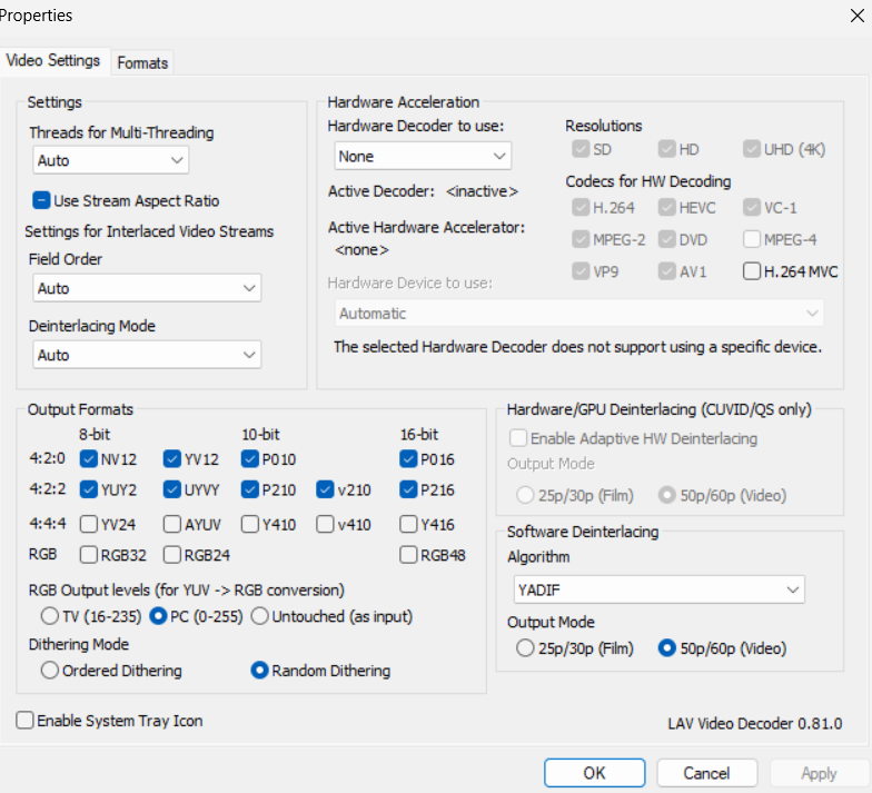

@Knievel Can you post a screenshot of your 'LAV Video Configuration' screen and one of the flv videos as an example as well.

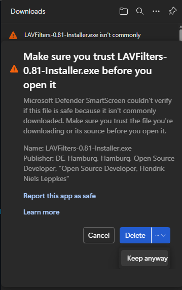

The link is from github https://github.com/Nevcairiel/LAVFilters/ but it shows the following :
I just click on the three dots on the right side (they appear when you hover over them) and click 'Keep'.
A second warning will appear, and you’ll need to click on 'Keep Anyway'.
I hope this works for other people as well.

My LAV settings (which i think are default)
