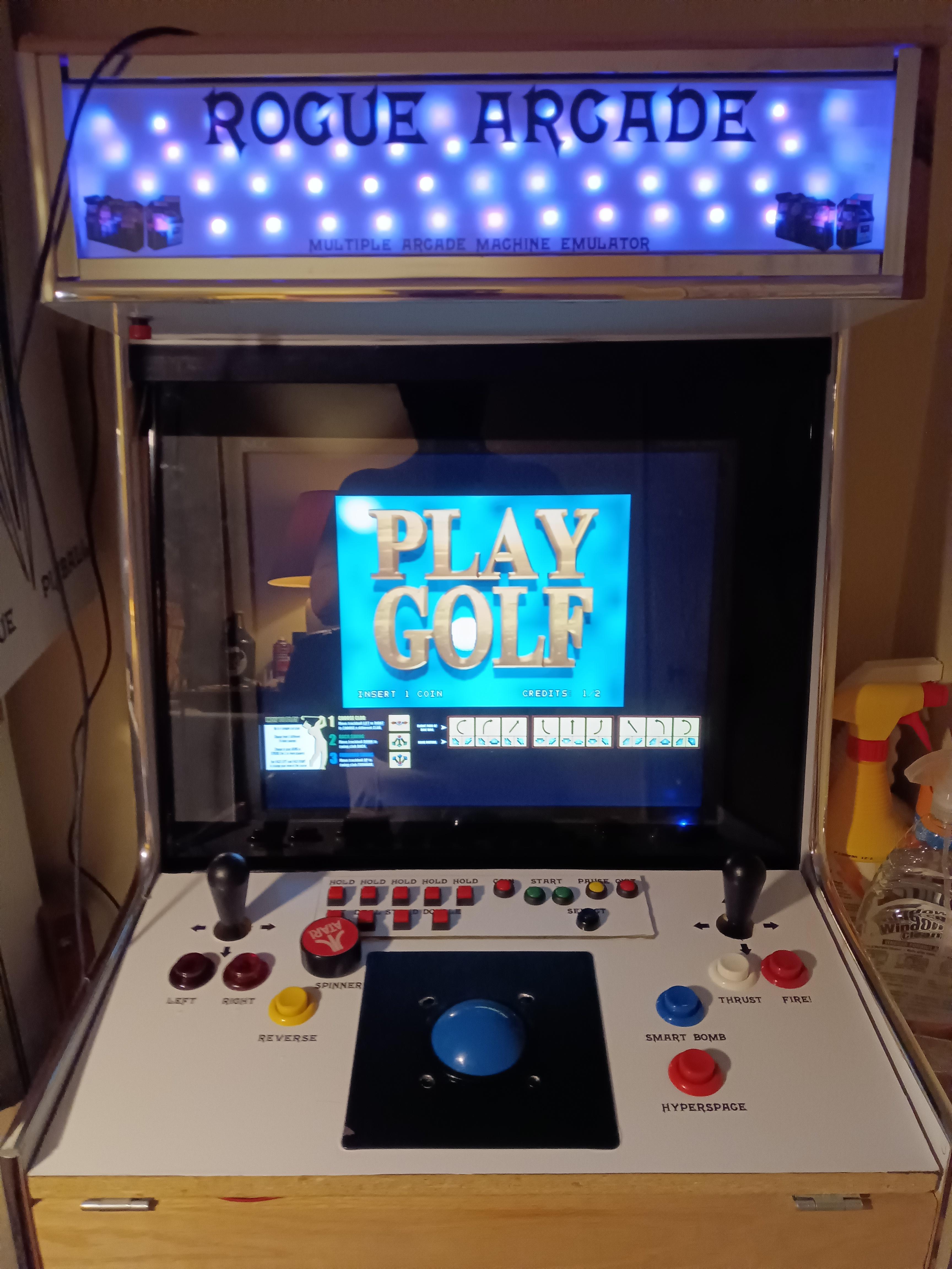

I'm reconfiguring my bartop that I made several years ago. I made a new control panel and have a new I/O board (Keywiz USB Max). The Keywiz is working fine, mame sees it and uses it. It's also listed in my devices and printers.
I'm trying to setup  exiting Pinball X. I have ESC working to exit the game, then I get the menu exit/shutdown etc. I can't exit Pinball X entirely, I can't get past the exit/shutdown screen. Both quit and exit emulator are mapped to ESC.
For some reason I can't map anything in joystick input settings (even an external keyboard). (When I press hit a key nothing happens). But, keyboard input settings will accept settings. I upgraded to 6.95 hoping it would fix this. I have to use CNT/ALT/DEL log off to exit PinballX. What am I missing??
