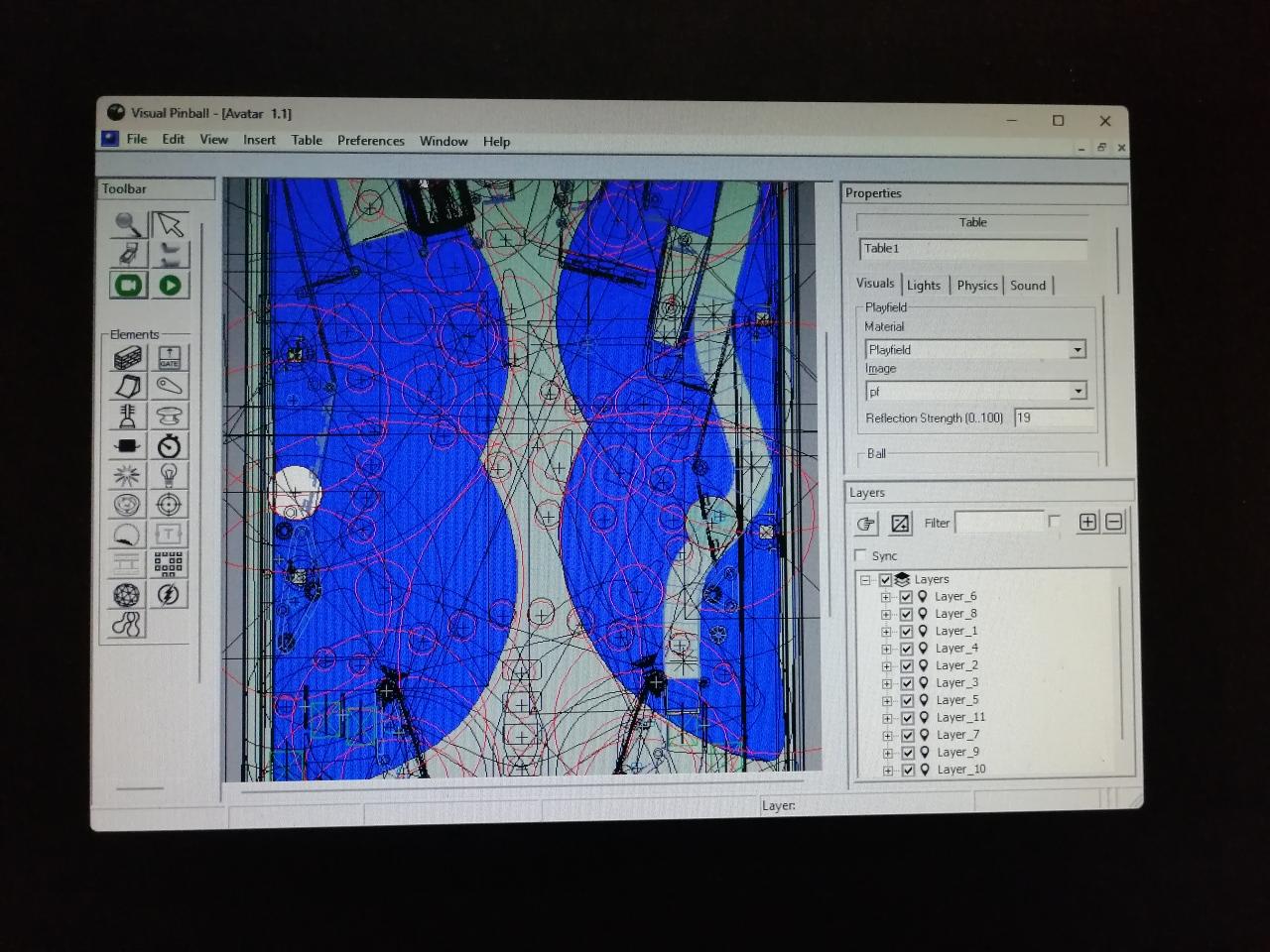

My problem now is, that if I end a table approx. in 80-90% I don`t get back to the PinballX frontend.
VPX is still running and it looks like this:
If I grab my controllers, I can manually close the VPX window and this brings me back to the PinballX menu.
The strange thing is, I can`t see a pattern here. I even tried the same table once several times. One time it worked, the other 4-5 times the problem happend as described.
Is there anything I can do to fix this?

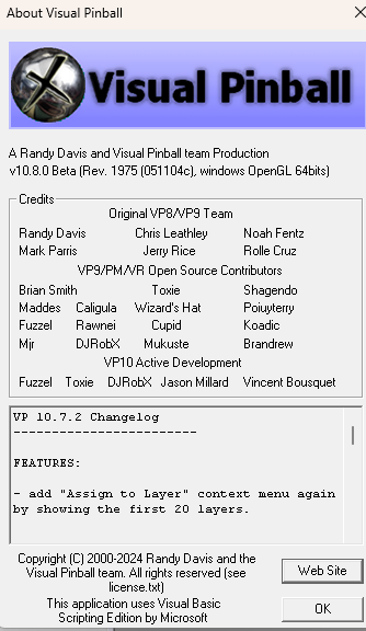

I use the VPinballX_GL64 version 10.8
As you recommended I´ll try a different key for the exit button. I`ll come back with the results probably tomorrow.
Edited by FRAQATTAQ
version numer was wrong
3 minutes ago, FRAQATTAQ said:
I use the VPinballX_GL64 version 10.7.2
Are you sure ? VP started the gl version from 10.8. Any pre 10.8 must be a custom build.
@Mike_da_Spike Your are absolutely right. I run 10.8. I was just confused after checking the "about" in VPX. But it was the changelog that I`ve seen. So I thought it`s my version number
You are running a pretty old version of 10.8. Still a beta.
Please update to release version https://github.com/vpinball/vpinball/releases/tag/v10.8.0-2051-28dd6c3
