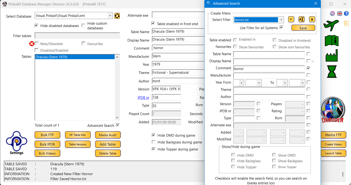

Yes, Future Pinball works outside of PinballX.

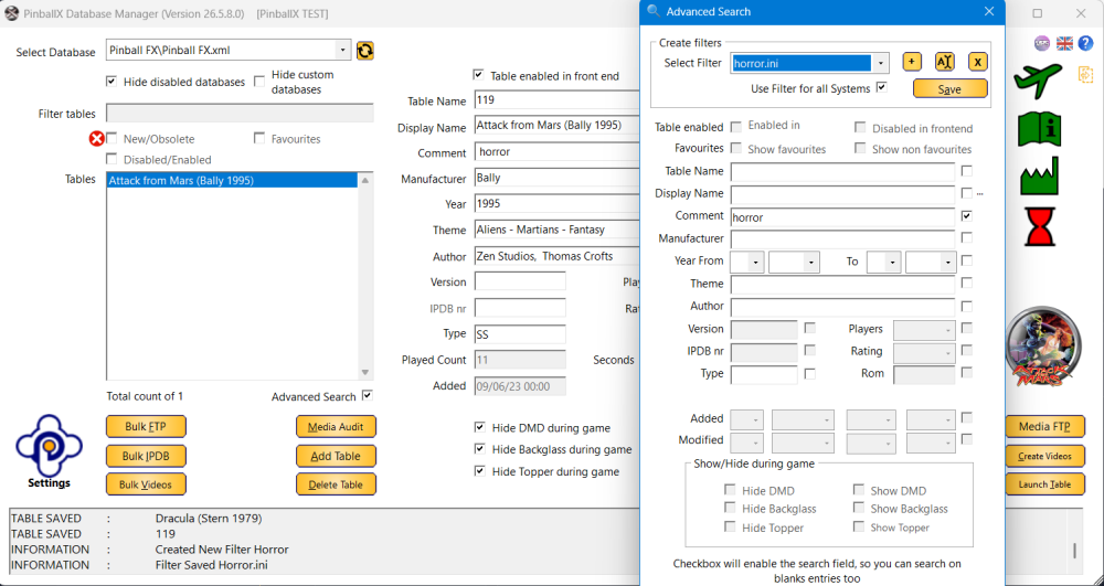

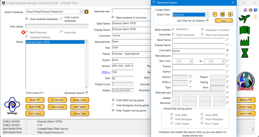

But I can't put a Horror Pinball horror.ini file in VPX and Future Pinball.
But I can't add a Horror Pinball horror.ini file to both VPX and Future Pinball.
I've included a video that you'll see better than images. It also shows that with the Horror.ini file and Data Manager 26.2.26.0, it says I can't have two horror.ini files.
https://drive.google.com/file/d/1Wh5kzJ0BWvJIGwStyWIE0Kbn-uCEuQ9c/view?usp=drive_link
Thats what I tried to explain in this post https://forums.gameex.com/forums/topic/31372-could-a-list-or-system-of-horror-tables-be-made/#findComment-227691

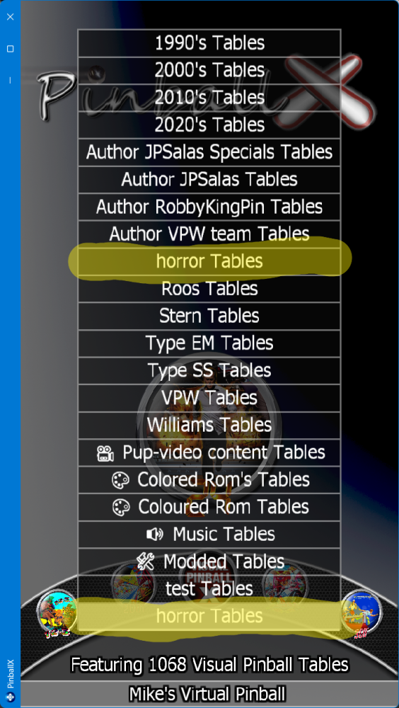

Action plan for you:
  • Delete 1 of the horror filters and just keep 1
  • Make sure your Future pinball system works from the frond end
  • If FP works from frontend, mark tables in the future pinball as horror, via the description
  • Also marks your Visual Pinball tables that you like to see as horror
This should show the filter in the frontend with tables from all systems that you marked as "horror" in the description.
If you got any questions, please let us know

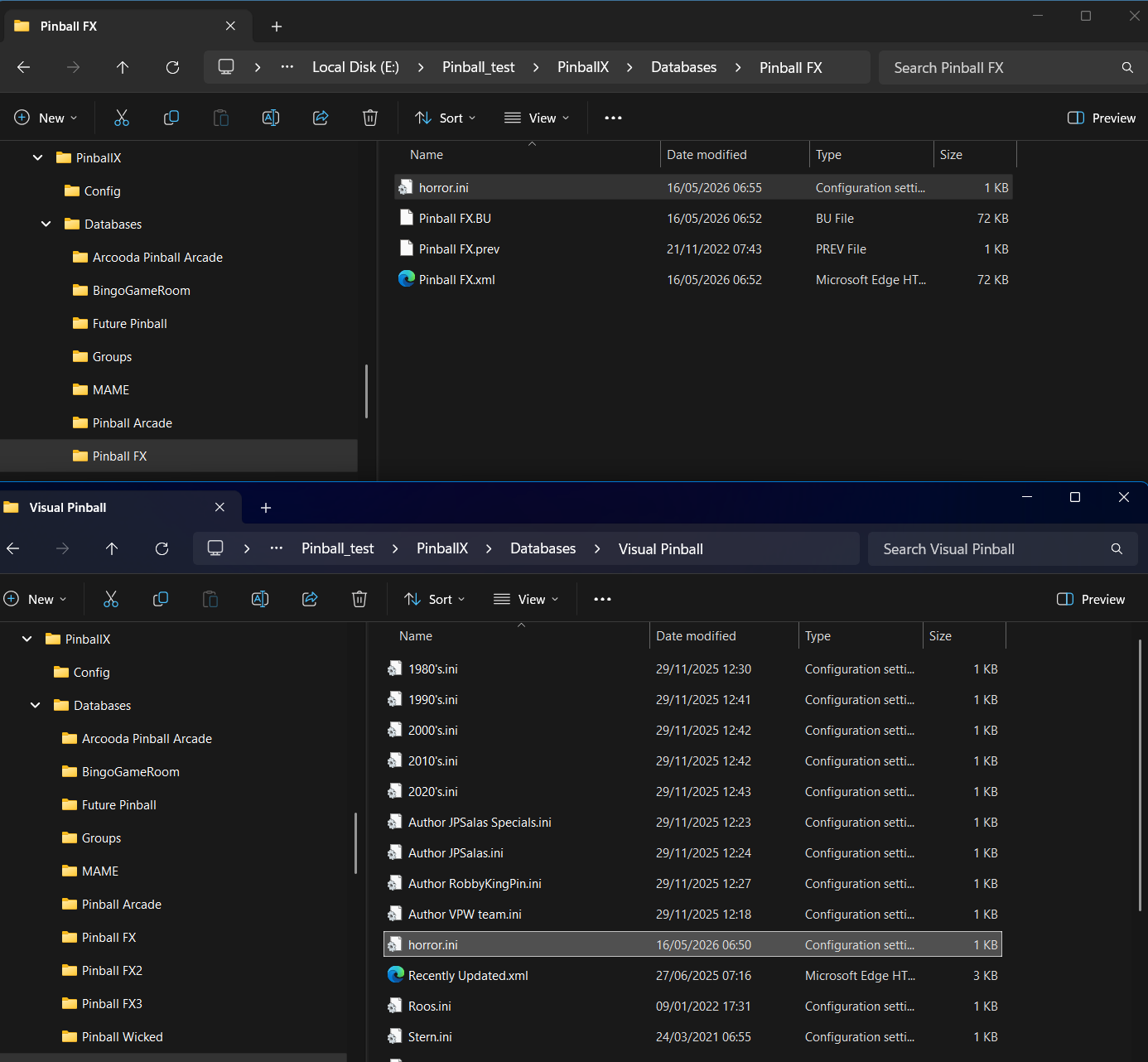

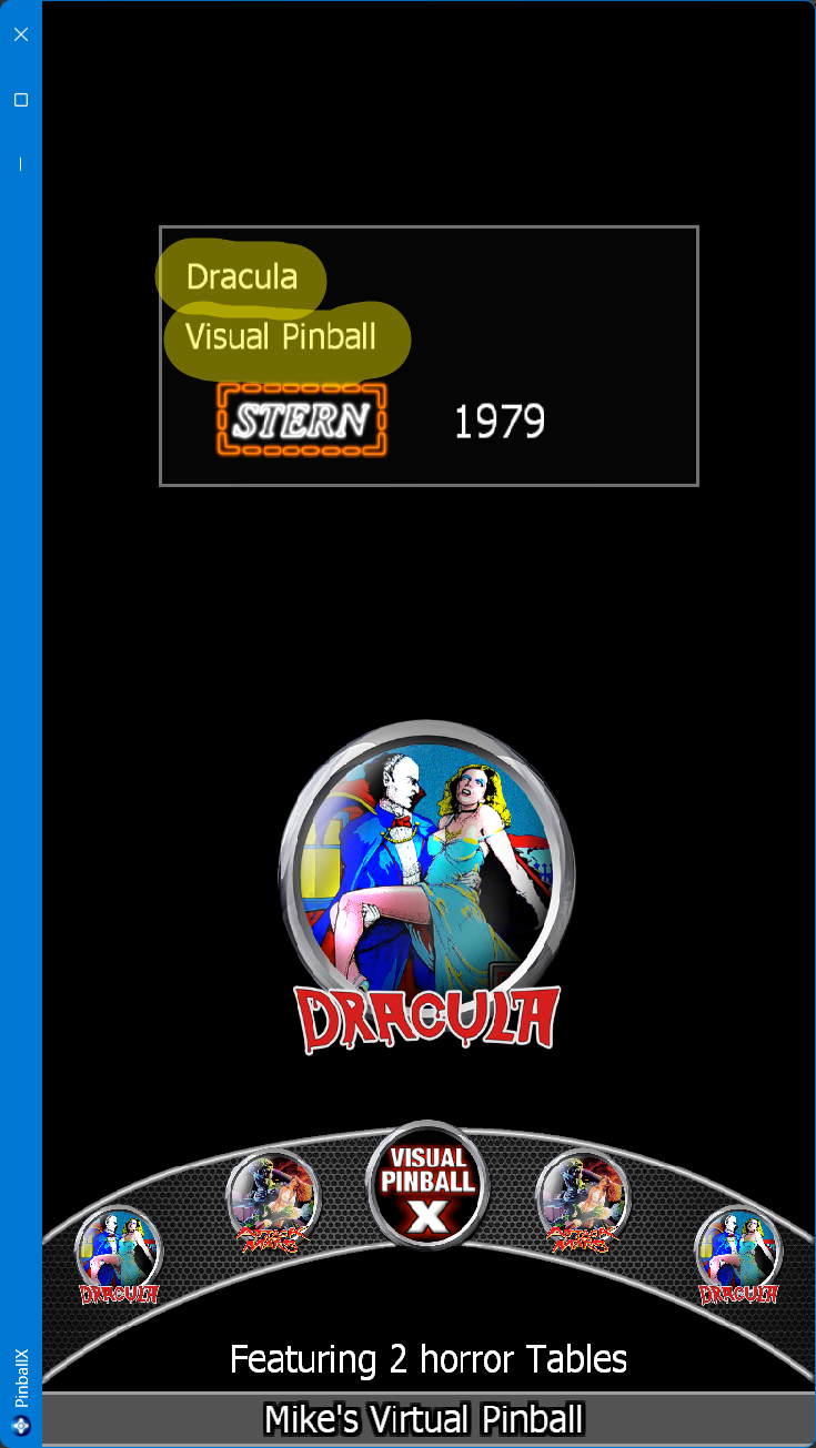

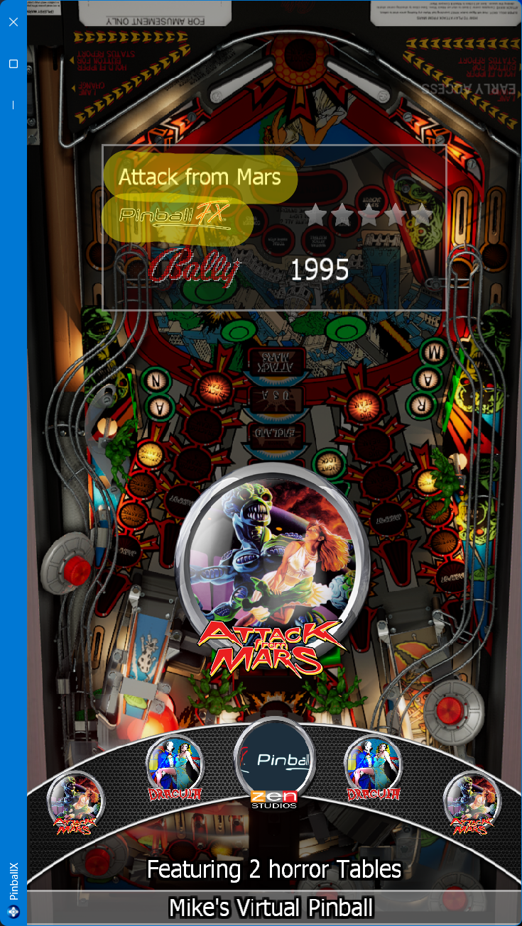

Although I don't have Future Pinball installed, I created 2 horror.ini as you had
1 in the visual Pinball directory and 1 in the Pinball FX directory (created via DBM). Attached 1 of the fles (only 1 is needed, but wanted to test)
My Visual Pinball Directory Already had a load of filter files for testing
Within Visual Pinball, I commented 1 table as horror:
I did the same for Pinball FX (just ATFM)

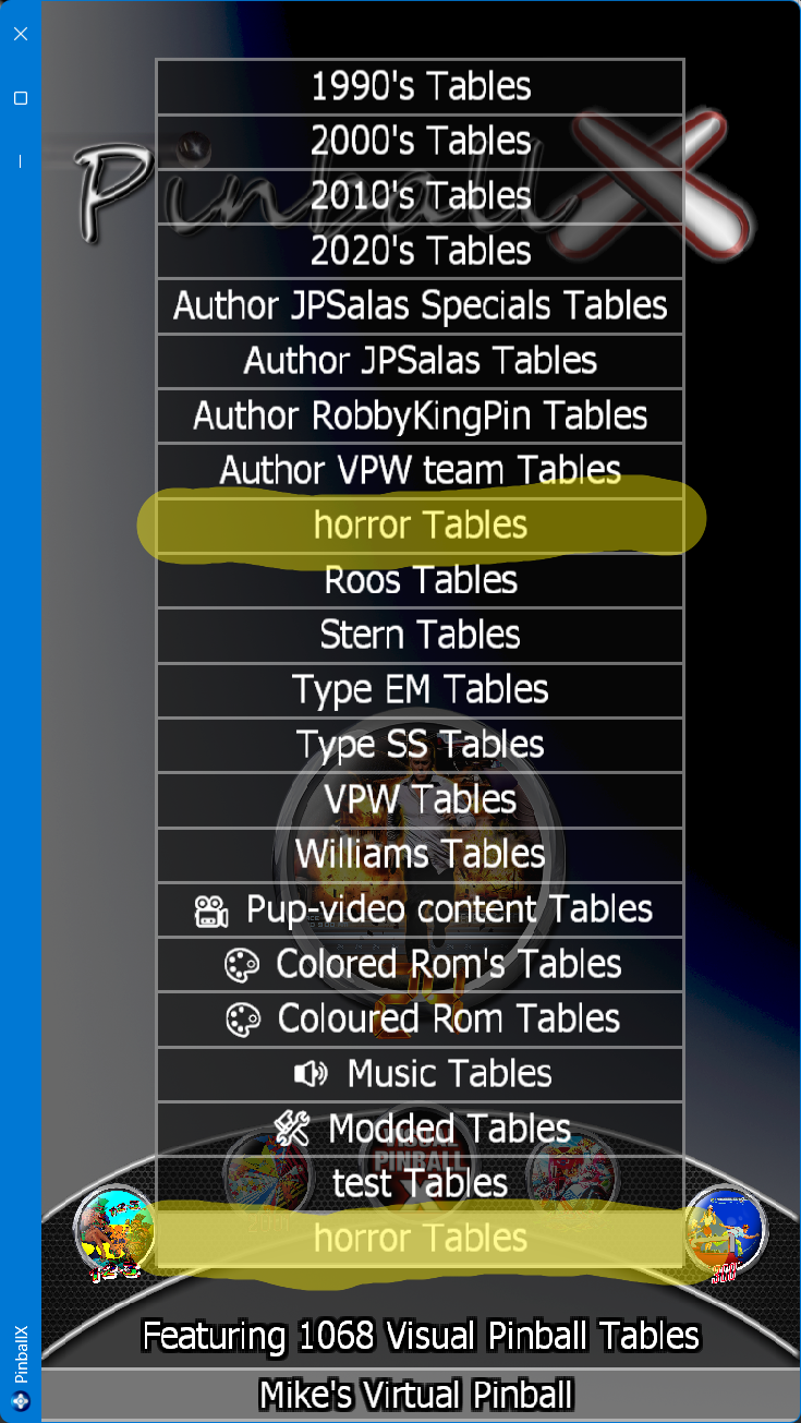

PinballX loaded and my list showed 2 horror filters :
Both filters shows the same result :
ATFM from system PinballFX
Dracula from Visual Pinball
When I click Dracula it loads Visual Pinball and when I click on ATFM , it launches my ZenPinball FX system

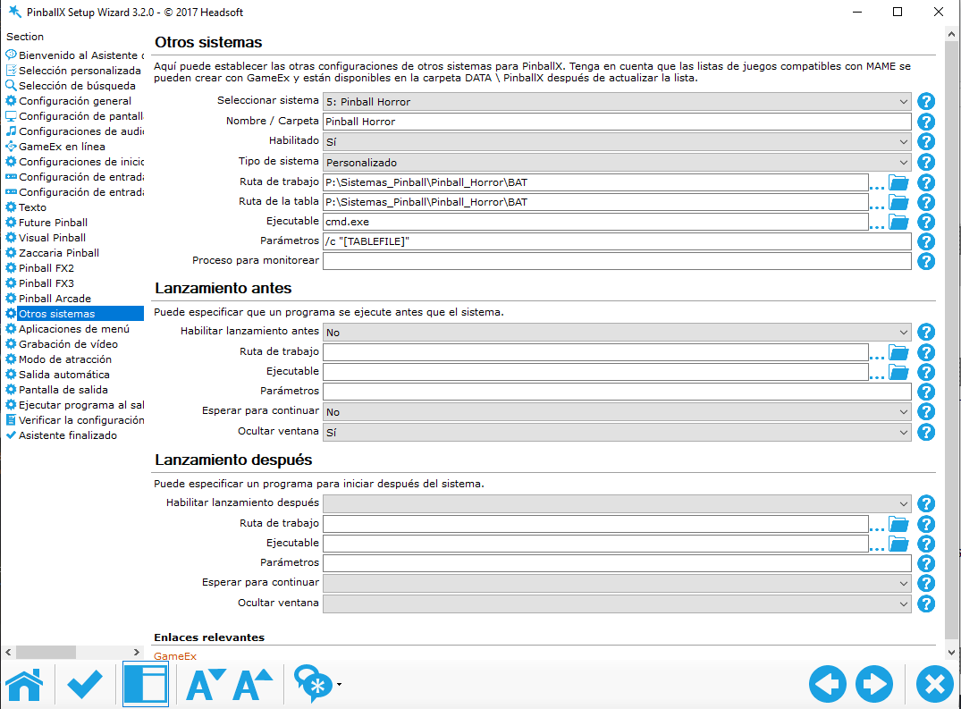

I have good news! I know I'm a bit slow to reply, but between work and other commitments, I haven't been able to do much. To get to the point, I've managed to create a new system that opens Visual Pinball X and Future Pinball tables from Pinball X. It's somewhat complex, but having all the tables from both systems together is fantastic. Give me a few days, and I'll post a step-by-step guide and a file showing how I'm doing it.
Thanks to @Mike_da_Spike and @Draco1962 for your help. It all seemed impossible, but I didn't want to give up, and so far, the tests with two tables from each system have gone well.
  • Like 3
I hope I do it right.
Here's a YouTube link where I uploaded my "terrible" system, which uses VPX and FP BAM tables.
https://youtu.be/TgAuOA6p4yU
It's made with .bat files because PinballX doesn't allow you to have two systems in one with tables. I've attached the .bat file for what I set up for Future Pinball, the VPX .bat file, and the .ahk file to close the process.
If it can be improved, which I'm sure it can, let me know so I can polish it even more.
