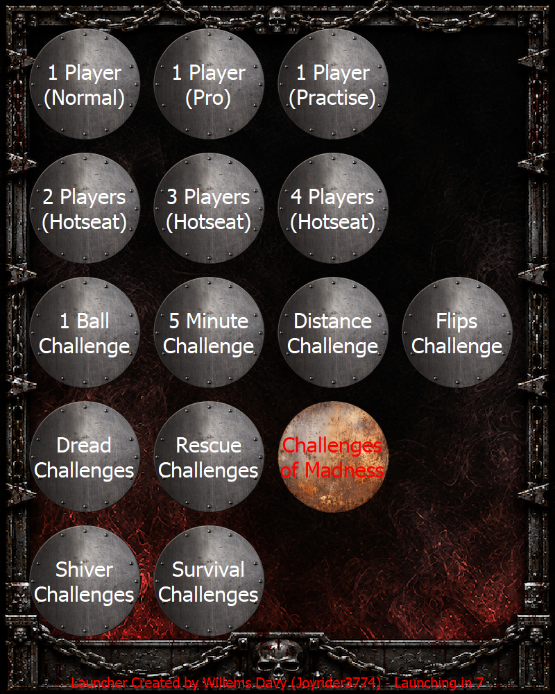

FX Launcher
To setup a direct table launch, for differrent modes or multiplayer, I modified @joyrider3774 his PinballX launcher, to use for FX
The files are in FXLauncher.zip

@Mike_da_Spike here are the other game modes, they seem to be working now and they had enough time to fix the issues so i'm telling them now. I've gotten these directly from the exe and i tested the challenge modes, they seem to be working (again) now at least if i tested them with biolab table
Challenge_BallLimited -> 1 ball challenge
Challenge_TimeLimited -> 5 minute time challenge
Challenge_DistanceLimited -> distance challenge
Challenge_FlipLimited -> flips challenge
Hotseat_2 -> 2 player hotseat
Hotseat_3 -> 3 player hotseat
Hotseat_4 -> 4 player hotseat
Practice -> practice
Pro -> pro mode (not sure if this one works but it was in the exe)
Classic -> classic mode
  • Thanks 1
  On 12/1/2023 at 3:43 AM, joyrider3774 said:
direct table launch does not seem to be implemented yet in M at least i could not get it working with the FX commands
Expand
I just tested it as well.
Although my assumption is that they used the same engine (code etc) of Pinball FX, I'm not able to use Freezy's dmd as well (no option in the menu)
and indeed, direct table launch doesn't work (why do they give tables id's ?)
I hope this would be fixed soon.
Anyway.I updated the FX launcher with the gameplays as @joyrider3774 mentioned.
Big thanks for the params and thanks for your work to the community
So it should now look like this :
