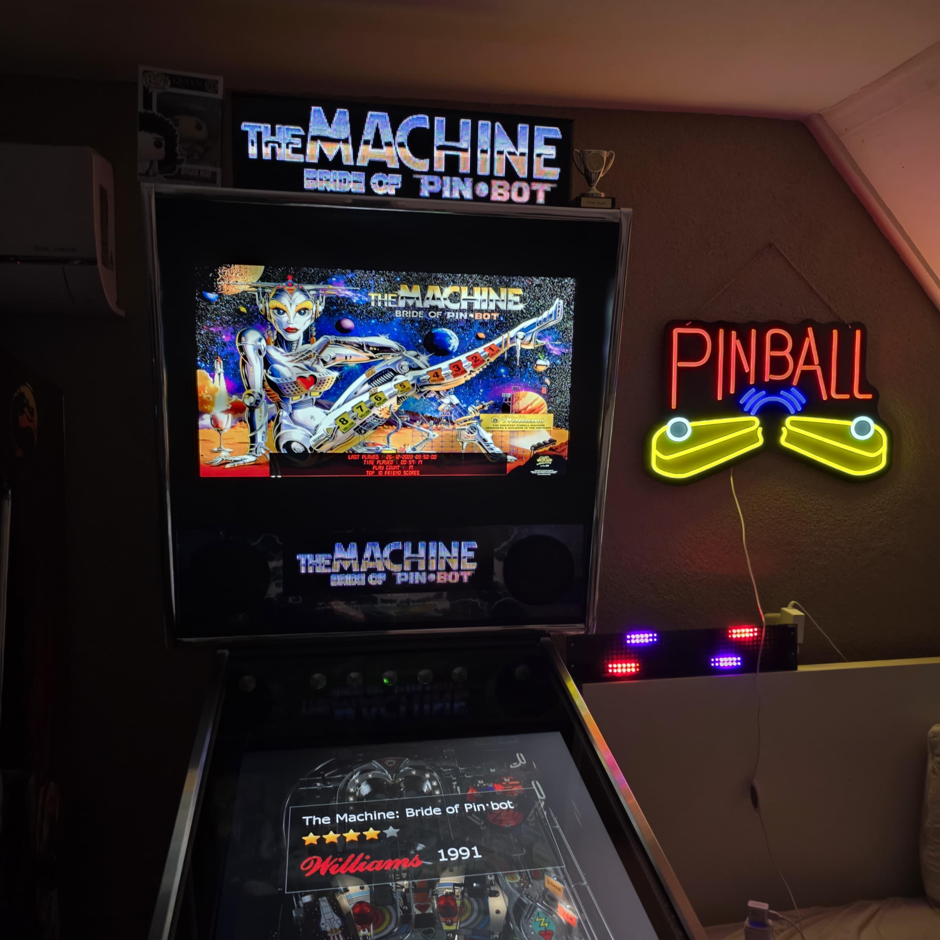

Due to health issues, I was unable to complete this thread about upgrading to my new monitor .
The Asus Rog Swift PQ38UQ is a 4K monitor with a 144Hz refresh rate.
Since the monitor cost around 1000 euros (discounted from the usual €1299), I was hesitant to remove the back panel.
Consequently, I had to install the entire monitor, which made the fit in my cabinet quite tight, and I couldn't slide it over the flipper buttons as with my previous monitor.
This led to a gap between the lockbar and the monitor, which I closed by adding a piece of wood that I painted black.
Shows the gap between the lockbar and monitor. If you look closer, you can see that the LED strip on the right was also removed. As the monitor was so tight, I could not add it to the cabinet without removing the LED strip
Inserted a small black wood strip to fill the gap.
Side picture showing my crocs as well :D
lockbar, ledstrip and glass placed again.
Perfect !
PinballX displays perfectly, as does Visual Pinball. With VP 10.8.0's new POV setting called 'window', you can set the playfield from the user's perspective. It offers a more 3D experience when playing in flat mode. It's difficult to capture on camera, so you'll have to take my word for it.

Enhancing my space with a little extra character.
I picked up this neon-style LED board, not just for the aesthetics, but for the atmosphere.
Over the years, I've learned that a well-crafted environment makes all the difference.
It’s not just about the rig; it’s about creating a space that truly feels like a trusted enviorment.
