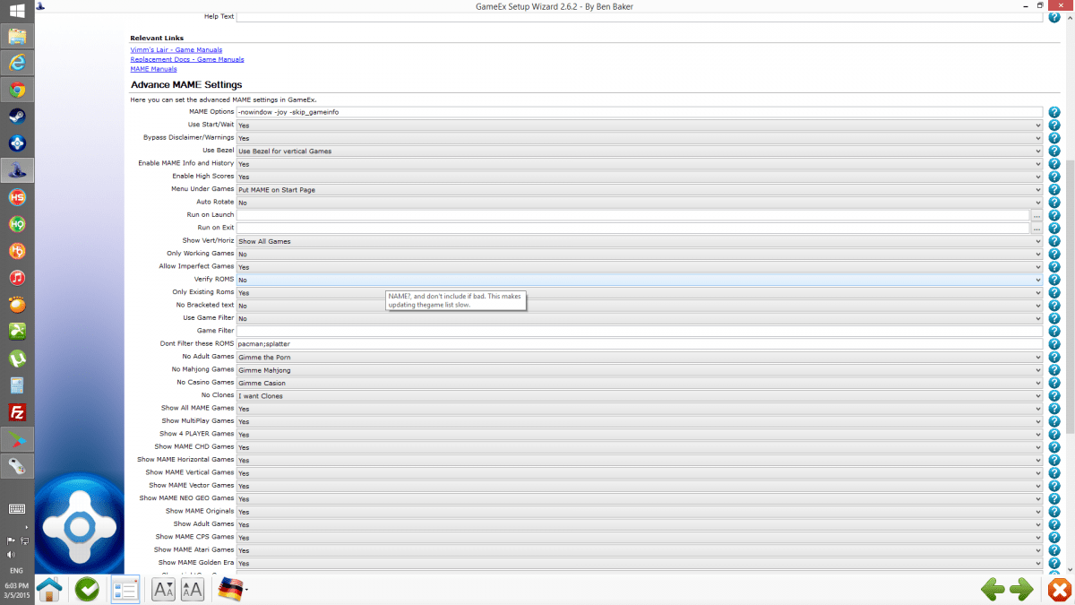

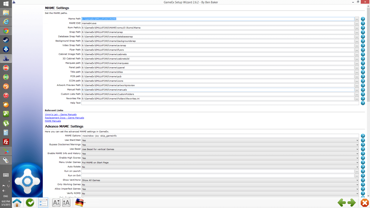

I have official mame 0.159 set up with mame 0.159 split rom set and chds.
When I run mame or mame32 all the games get detected and I could play them.
But I only see 300 some games (including clones) in gameex. I have tried many different mames and configuration other people suggested in other posts but same results.
I attached my mame settings. What am I doing wrong?
Any help would be appreciated! Thank you.

That seems odd in itself you should be able to literally put them just about anywhere and point to them without issue.

You seem to have 2 rom paths set in your screenshot:
E:\GameEx\EMULATORS\MAME\roms;E:\Roms\Mame
any reason for this? Usually you would have the whole romset in one folder. You may want to try deleting that whole entry and use the browse button to find your roms. Or manually remove one of those paths.
In addition to Dazzle's suggestion please do post a copy of your GameEx.ini and your GameEx log, if that doesn't resolve the issue. Seeing the information contained in these files will allow us to get a better picture of what's happening. Here are some instructions, if you're not entirely sure of how to get to that info. Thanks! :)
Btw, MAME supports multiple paths when integrated with GameEx (had to program around this in my plugins) so he probably just changed the path and it appended the default path GameEx comes installed with which shouldn't cause this.
I tried single rom path before, and tried again this time. Checked the log and one line says total verifiable rom is 0. Would that be a part of problem? Posting the entire log. Thanks guys!

Where are the other requested files - gameex.ini? Also, you never confirmed if you are using integrated MAME support or running MAME as a separate emulator. Help us help you by providing all files and info. Thanks!
Your config is integrated MAME.
Check the wiki emulators section for where it would be if you did run it as an emulator. It's good you're not doing this, as it would bypass all the built in features GameEx adds to MAME.
That said you could configure a slot for it just as with many of the emulators you already done this for: acrade>mame
<edit> question about version deleted - Never mind, you clearly state 0.159 in your OP
I don't see anything standing out as incorrectly configured.
Edited by tthurman
Hmmm, everything seems correct from your ini...
The only thing i can think of right now is do your support files (mameinfo.dat, history.dat etc) match your MAME version? A quick and easy way to determine whether they are having any influence is to delete them from your your MAME Setup (remove their paths) then Update List again.
I thought about suggesting the history.dat ealier, but then thought nah. So since we are thinking outside the box so to speak, another idea I had was to toggle the fiilter on, remove Japan, and update. Just an idea!
That did it! It was touchscreen set up. I disabled it and updated now I have all the games listed. All games that were available were shooting games so I think it had to do with touch setting. Thanks for all the help!!
