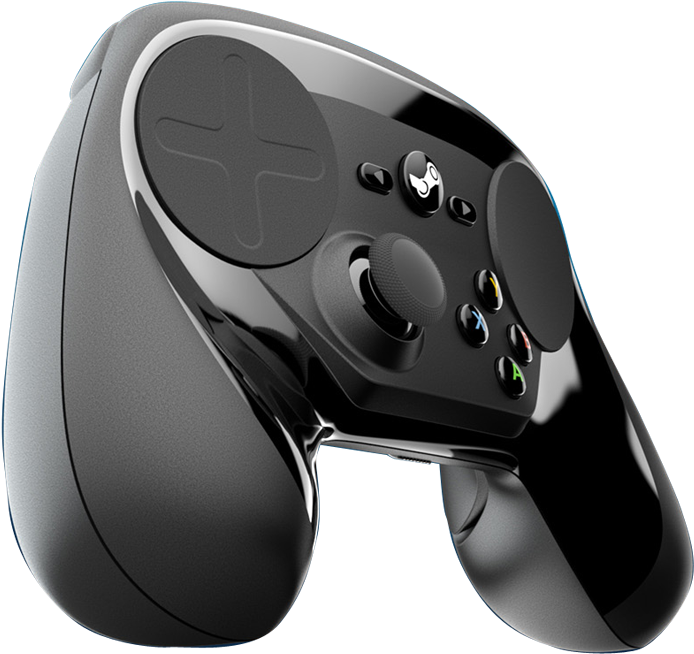

Anyone have any luck using Steam Controller (2015) BLE? I am experimenting with this and will report back with my findings. I want to be able to use this on my Atari VCS 800 (Should I rename it to Atari VCS 1600 since I doubled the RAM? 🙃) under Bazzite? It says Ubuntu and SteamOS supports it, so it should be OK. I think there may be some hurdles just getting it to work via Windows.
