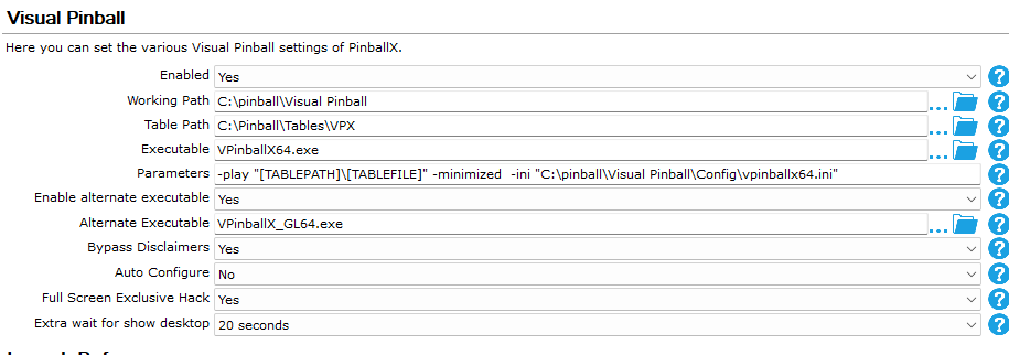

Now PBX has become stable on my system I am added more and more tables to it and also using it more and more to play pinball on my desktop. But I have not used it in VR (Quest 3) yet. I play VPX tables in Desktop and VR. Sometimes I prefer Desktop, sometimes VR, for the same table (vpx file). Is there a way to choose from the PBX frontend what VPX executable you want the use (e.g. Start in VR, Start on Desktop). For desktop I always use the 64 bit DX version of VPX and for VR the 64 bit OpenGL. A possible workaround would be adding all tables twice, but… that is no ideal of course.
There is no way to chose executable dynamically in the UI but it is a great feature request. you could pick to play game with a different executable.

I really like that idea so I just added it.
new version out in a minute.
Thanks Tom for adding this, also at this short notice! Just tested it and it works great.

I do have one question though:
Would it also be possible to add an alternate command‑line parameter?
For VR I use a different VPX setup than for my cabinet. At the moment I created a second system entry in PinballX that points to the same table files, but launches VPX with a different INI file through the command line as well.
Having an additional “alternate parameter line” alongside the alternate EXE would make this workflow much cleaner and more flexible.
And great thought to also make the alternate parameter available in the TEXT section of settings.exe.
If I have a free moment, I will add it to the manual and will send it to you
@Mike_da_Spike You read my mind on the TEXT for the ‘Play Alternate’. I upgraded already again to the new version and added the text “Play in VR”.😄
@Tom Speirs Thanks for another quick update. You mentioned the alternate parameter is not optional, but when I upgraded the alternate parameters value was empty in the settings. I copied the value of the normal ‘Parameters’ to it manually. But I could als make that value empty again, so having a value in it is not enforced by the Settings program?
