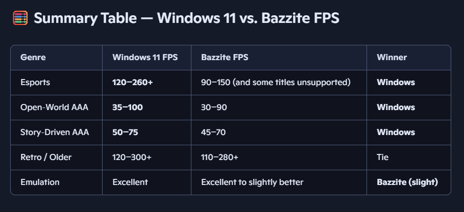

  • First, given the limiting nature of the very proprietary architecture (motherboard, PSU, chassis) I am at the limits of what this system can do. That is not to say that it cannot play any games. It certainly can! BUT, I have another build on an older DDR3 system that knocks it out of the park in comparison, even working well in 1440p! Here is a summary of the anticipated FPS performance (1080p) across various genres of Windows 11 vs. Bazzite for this build:
