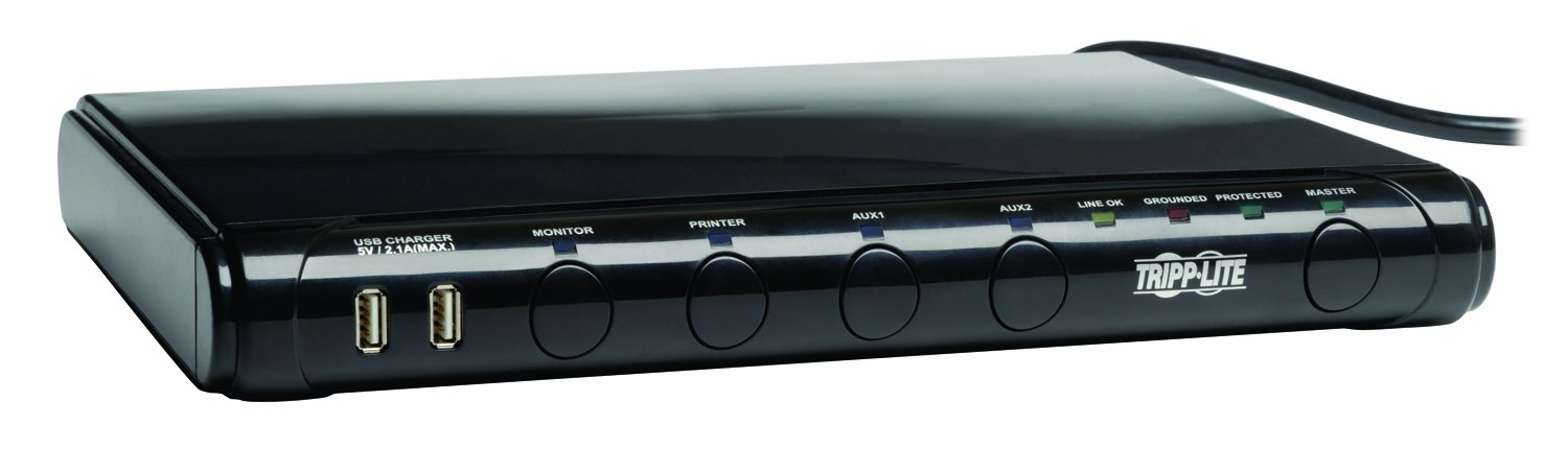

I believe he's referring to what I believe to be a desktop power distribution unit at the bottom

You are correct. I also have a power strip that is connected to it unswitched for powering the Xbox console stack. Still a bit of cleanup and configuration work to do. Then have to add my Xarcade Tankstick to the mix in front of the Sammy.
Nice clean setup!
ooohh! I thought that was some obscure console or summat.
It is an under monitor power strip basically. Since there was a useable gap between the shelf and the desktop, it was an ideal place for it. I may shop around for a black one as the white stands out a bit much for my preferences.
Possibly something like this Tripp Lite one with the duel USB charging ports on the front... https://www.amazon.com/Tripp-Lite-Under-Monitor-Protector-MT-6PLUS/dp/B0000512E1/ref=sr_1_2?ie=UTF8&qid=1485976119&sr=8-2&keywords=under+monitor+surge+protector
I'm sort of surprised anyone still makes those.  I remember having a beige Fellowes model sandwiched between my 486 DX2 and 15" monitor, but can't say I've seen one since.
The piano black on that TrippLite would be a nice accompanying dust magnet with my PS3 :lol:
Ok, maybe I'm lost... what is the purpose of these?  I mean, I have a surge protector power strip already, with a big red switch to turn it off and on.  Does this basically do the same thing but allow switching on/off each device separately?  What's the benefit of that when you can just hit the power button on the device (monitor/printer/etc)?  I guess I just don't get it.  I did a quick search, and NewEgg even sells them in 1U rackmount style for servers.  Why would I want one of those?
I always thought they were more of a convenience factor from days gone by.
Years ago it was not really the accepted norm to just leave stuff on all the time.  You came home, fired up the computer, dialed in, checked the BB / browsed the web at a snails pace, played some Doom, shut everything down and went to bed.  You control the power for everything right here, speakers, printer......
I have had several of these over the years and like the convenience of being able to switch individual components off or all at once. Beats trying to switch it all off when the strip is under the desk.
