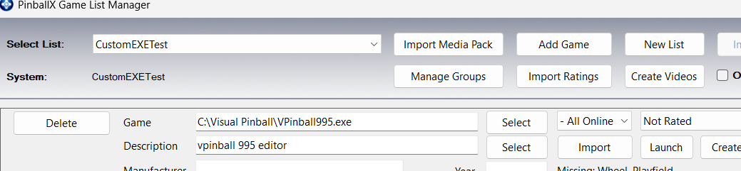

  4. For a simple test of the theory i used the VP995 editor as the exe set up like; (no launch before/after needed for my test) Then in Game Manager (Database Manager has some issue with Custom Exe systems which we'll address in a future release) you can add any exe found under C:\Visual Pinball as a game. Note that the game includes the full path; When launched from PinballX the VP995 editor launches and is closed from PinballX Note - The PinballX log file will show the launch as "C:\Visual Pinball\C:\Visual Pinball\VPinball995.exe ", which wouldn't work but as the exe is launched ok i assume this is just an issue with the logging for Custom Exe systems in PinballX. The changes you'd need to make to this configuration to test on your set up would be to change the Table Path folder to the root folder containing your game exes (can be in sub folders), and add the launch before after stuff for your screen switching.
