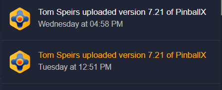

Could it be related to the fact that a second version 7.21 was uploaded last week?

2 hours ago, Mike_da_Spike said:
Edit :
Maybe but i just can't remember. I've been working like a Siamese on katnip!
