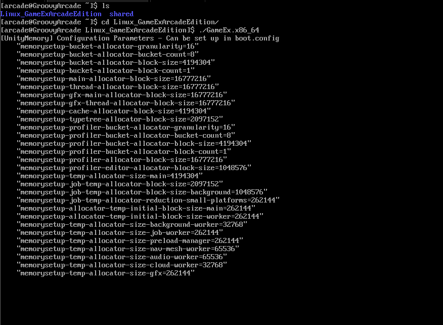

I did a quick test and no luck. I get this output then it stuck there forever.

Ps: I persisted with it. GameEx does work but you have to launch it from an x window manager (run startx from the shell).
There are workarounds to not need x windows.
