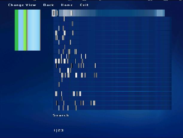

I guess the other thing I should make mention of is the graphical errors im encountering as well. I included a screen shot of game ex in light game selection mode. Id like to argue drivers too but I have the latest direct x and video drivers.

I would verify that you are running consistant screen resolutions. It is possible that your GPU may not support 640x480 or less. I would set GameEx and my theme to run at the same resolution if possible, 1024x768 is fine for most. I noticed in the log file 3D Alpha Blended Animations are enabled. Try changing this to 2D in the Advanced Configuration utility. You may also want to experiment a little with the Tweaks/Performance settings and set defaults to those that equire the least amount of CPU usage. That may help to free-up resources for the GPU and minimize some of the display issues.
As many will tell you here, drivers can still be a problem. I have seen it often where there are issues when a driver is upgraded from one version to another insteald of the old driver uninstalled adn new driver installed fresh.

You have to remember though its not the games that are running slow. They go great its the front end's menus that are running all choppy, blurry and 1 fps. It probably is a driver but they havent released any new ones.
Hate to see you go so soon as I think there is probably a solution. There are plenty of low profile video cards that would likely work with your system, but since you are attempting an NES mod setup, I may be incorrect. Good Luck!
