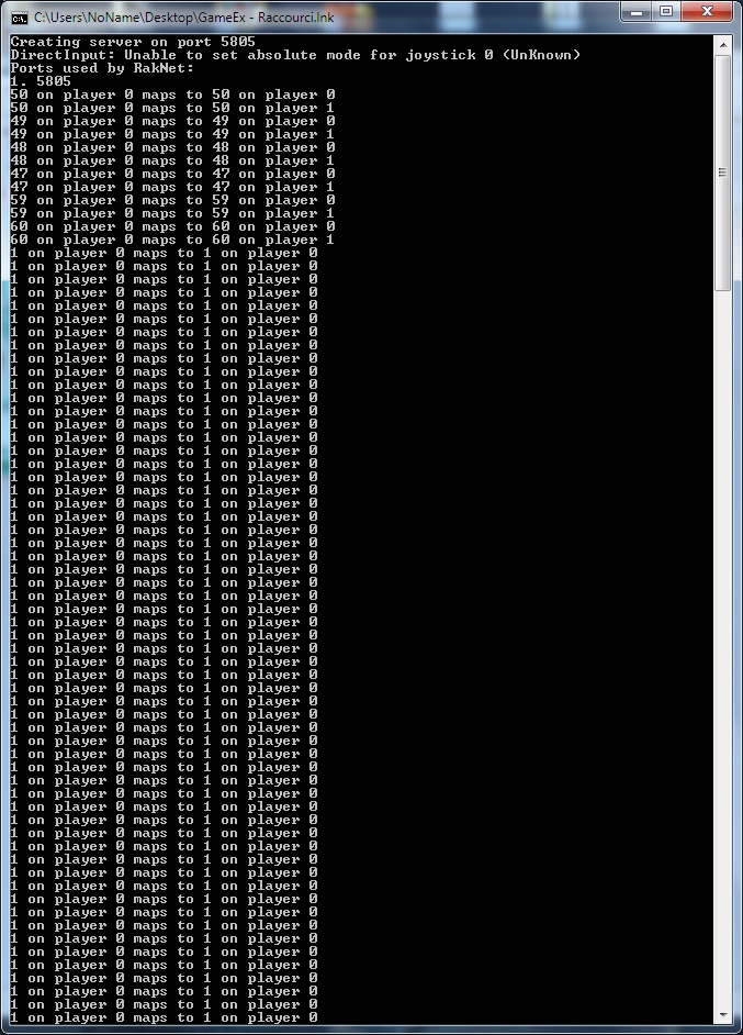

I received a play request and heard the audible prompt, but as the game began to load I encountered a video error. Here is a copy of my Log...
Also - a screen capture from MAME
I changed the Advanced Mame from Yes to No. This allowed me to play the game solo. Next, Chrisqc and I attempted to play Giga Wing. I received the SAM prompt and the game began to load (saw the CP), then screen went black for a few minutes and then back to GameEx NetPlay menu... sigh.

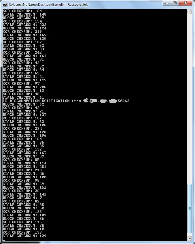

i dunno if you see the game loaded but for me i accept the request and the game goes ingame ,i chose 1st player start and then goes ingame...but nobody start player 2 ... i think that if you host a game you must be player 1 ...and the one who JOIN the game shall be player 2 ...something like that ...annyway i will host gigawing for annybody who want to test,yesterday i did where able to play with someone :) but he reported that there where lot of lag ...for me as the host there wasn't any lag at all

i done a test with someone,as a host the game came ingame here and i waited for someone to imput credit or start a game but it did nothing

I looked through the blog at the 0.2 release in August. He notes that "Cross platform and architecture support: I was able to play a game between a 32 bit windows machine and a 64 bit linux machine with no problems." So not so sure he is referring to networking. No, only 32bit Windows. I reverted to MAMUI32 from 64 just in case. Still pretty much the same results. Have mapped port forwarding for 5805 to my PC and entered appropriate rules in software firewall. Tried playing Gigawing with Chrisqc again... no video issues this time. appeard about to connect and game loaded, but it was just me playing. Throwing in the towel for the day on this issue.. blink.gif
