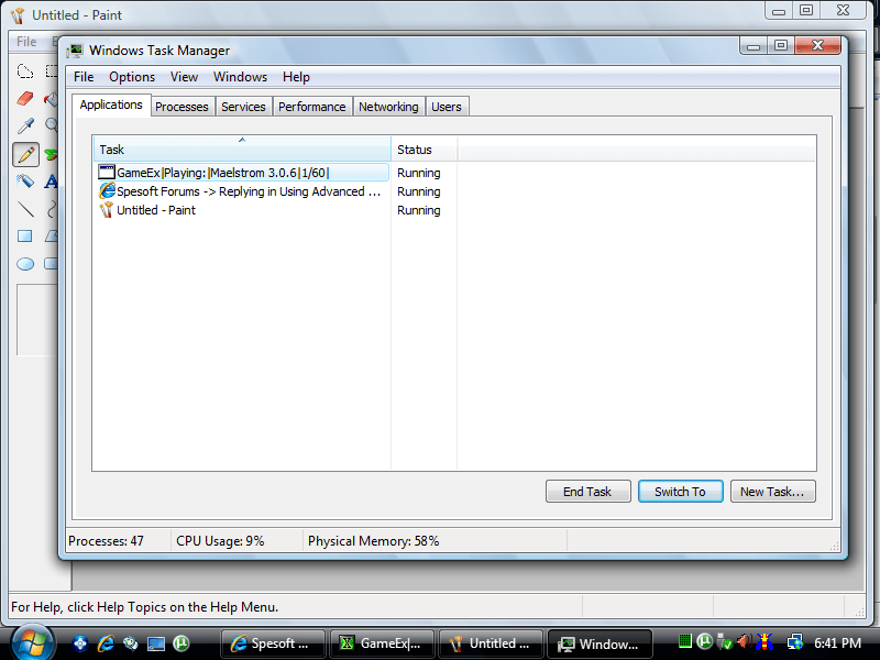

Haha :lol: well it isn't quite THAT easy. Shortly after I had posted above I DL'd and setup AHK to do exactly this but it still doesn't work. After the program quits it doesn't return to GameEx. It dumps me back on the desktop with GameEx minimized and unable to be maximized (see screenshot) and I end up having to kill it with the task manager.

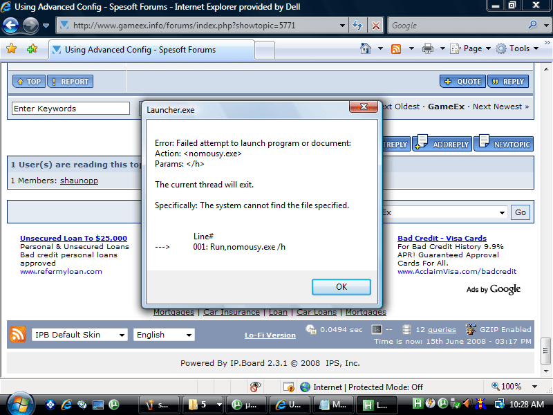

Still no luck but I'm not sure how you meant this to be incorporated. I first tried filtering by .exe and just running the launcher with no luck. Then I kept my filter by .bat so my batch launches the game with your launcher targeted under Launch Also with no luck. I get the error below.
Can you send me the AHK file so I can see what's going on under the hood?
Thanks man.
Thanks man.

In the attached Config.zip Ive included 2 things...
1 the gameex config that needs to be imported
2 the program+loader+supplmental files needed
It sounds like you didnt get it all.
EDIT: I did include the source.
I saw your screeny... You defently didnt grab the above config.zip
