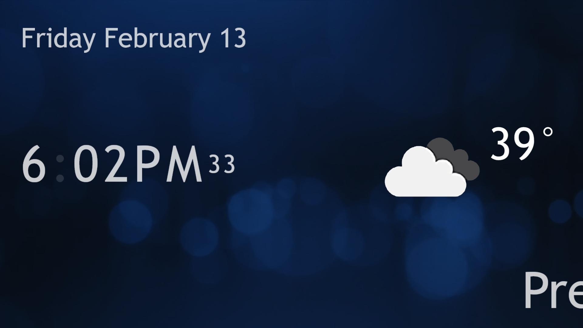

i keep getting the weather screen. but im trying to get the mode that just plays random demo videos when screensaver is started. using current version. lav filters installed. what step am i missing here? the directory is correct. they are all mp4s. they have all played before. has something changed? my movies and tv shows play fine when i start them. i just want the demo video screensaver.

but my movie, and tv shows play just fine when i select them. its just the screensaver switches to weather instead of random videos.

It worked the first Load and now its back showing the weather screen. the music, movies and tv shows play fine when i go into those categories now. The Only problem im having now is the videos wont play in the screensaver. they go to that weather screen. Is there something in my settings im missing? thx

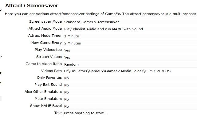

On 2/25/2026 at 2:43 PM, Tom Speirs said:
top setting is wrong in that one.

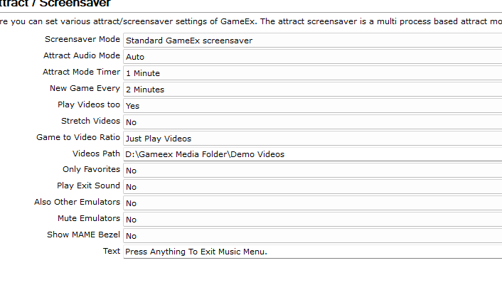

same result sir. do you want the log and ini again?

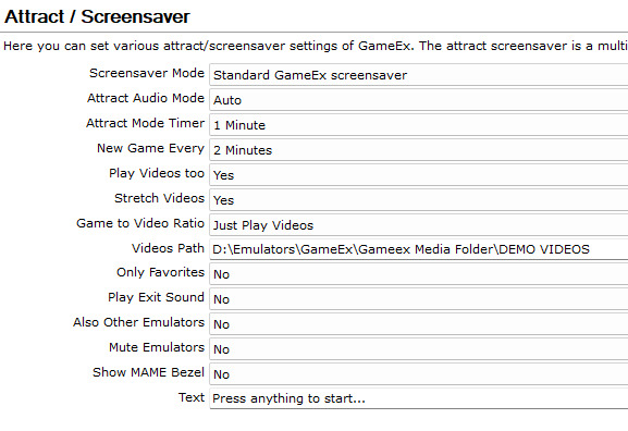

14 hours ago, Tom Speirs said:
Do the ini and ill put it right for you. Thanks.
Ok It Was first On Standard Gameex Screensaver. the videos were'nt showing. Then i Changed It To Time Weather and slide show. games still were'nt loading. then i changed it back to standard gameex screensaver, ran it again and all the videos started playing this time!! seemed like i had to change it to another option and run it first before it would save and change to another option. I hope it Doesn't go out again. thank you sir.
