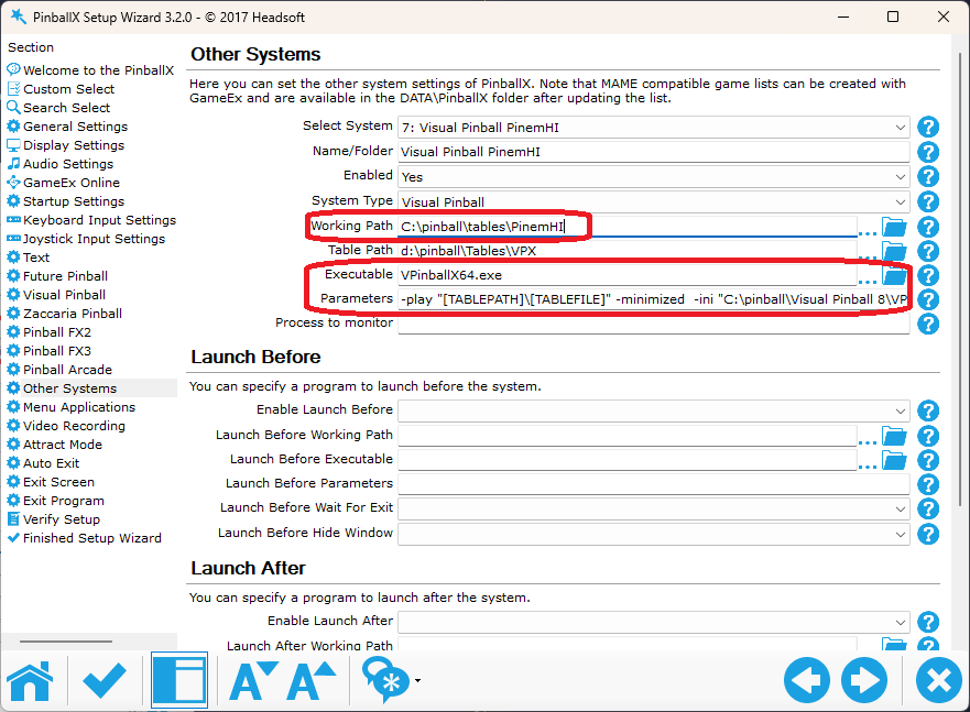

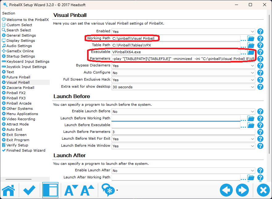

  1. Create dummy table files for the Pinemhi Weekly and/or 5 Min Challenges & Golf Challenges and place them in your Visual Pinball\Tables folder (you can find dummy table files in the Support Files attachment)
  2. Using Game Manager or PinballX Database Manager add the dummy tables to your Visual Pinball system (make a note of the table descriptions / display names used)

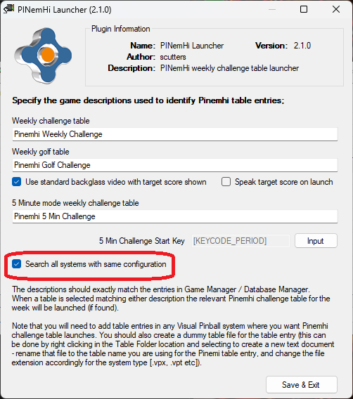

  6. Configure the plugin via the Plugin Manager Configure button
  • Enter the EXACT game descriptions / display names from step 2
  • For the Golf challenge you can optionally select to have the plugin replace the PinballX backglass video with a standard one that shows the current closest to the pin target score, or to speak it on game launch. The score on the backglass video will always be in the same location but the background image can be changed by updating the PBXPinemhiLauncher_BackglassGolfScoreImage.png image in the \plugins\PBXPinemhiLauncher_Working folder (after enabling the backglass video option and running PinballX once).
  • If using a key to start and stop 5 minute challenges use the 'Input' to set the same key code as configured in Pimehi, the plugin will send this key for you when the 5 min mode table is launched and exited. Note this option is for key codes only, if you have a button assigned then i assume you can easily start stop 5 min mode manually, in which case this can be left blank.
  • 5 min key exit delay - this controls how long after the  5 min mode table has exited that the mode is turned off, this figure can be increased if the pinemhi mode is being turned off before the score has been submitted online.
