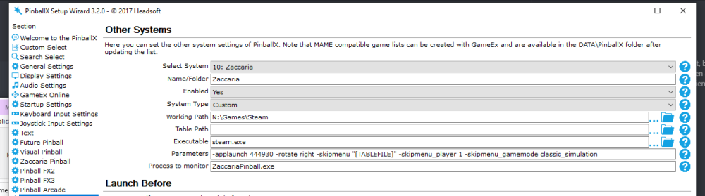

Is it necessary to use the launcher?
I suppose the -skipmenu parameter can be added directly in the PinballX configuration.

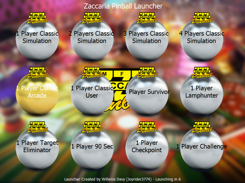

No definatly not needed, however only -skipmenu is not enough, if you only use -skipmenu, the game will show the game options menu. You also need to provide -skipmenu_player and -skipmenu_gamemode for it to completely skip all menu's. Here is example setup without my launcher:
if you rather play with arcade physics / settings use -skipmenu_gamemode classic_arcade
Go to your pinballx directory -> databases and under there the system where you have zaccaria
Rename the xml thats in that directory for backup (remove xml as pinballx will still use it) and copy the xml with the same name as your old xml has
This is how it looks for me now :
