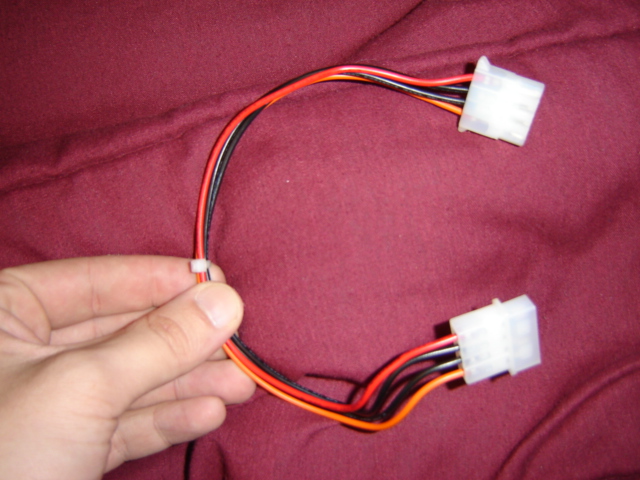

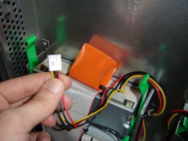

ok, well i've taken some pics, and i'm not sure if this can be done now. what i've decided to do is disable my floppy drive by unplugging the connector. (pic 2). now if i cut these 4 wires off of that mini molex cap is there a way i can insert them into the molex extension i have in pic 1? also, the plug in pic 1 is what i bought, and instead of a yellow and red wire, they are orange and red. i'm guessing yellow is orange in this case.
over all is this duable, or do i have to buy a molex plug with 8 wires (4 coming out) like the plug in my cd-rom drive? do they sell them?

Here's a pinout for that:
but like TX_TRINITY said, you'd be better off with something like this:
that's like $3 here in Sweden, shouldn't cost much anywhere in the world. And it's not as unsafe either.

DID IT. thank the heavens. if anyone is interested, i purchased the Y adapter power cable for a 5 1/4" disk drive. (found near the floppys at radio shack). along with that a 5 1/4" disk drive extension (looks like the y adapter only there's a male and female jack a piece, vs the Y with its 2 male, 1 female. I opened the pc, and unplugged the power cable from the cd-rom drive, and inserted 1 male end of the y adapter. i plugged the cd-rom into the female jack of the adapter, and then plugged the last male into my extension. (i did the extension to make it long enough to come out of the back of my pc). then you take wire, i ended up buying 300v 18 gauge stranded. i stripped about an inch of the plastic off of 2 - 1 foot pieces of wire, twisted the strands, laced one in each of the prongs on the happ coin door bulb and twisted around to keep from coming undone (i guess you can solder, but i'm just riggin it cheaply). one wire (doesn't matter which) is stripped, folded and plugged into one of the black inputs on the power extension coming from the pc. (folding it makes it bulky enough to just squeeze in, no need to crimp in my case). then the other is run to the orange part of the plug because the red must be the 5v in my case, for it was a lot dimmer. hope this helps, i'm gonna fixate to the cab tomorrow and do the final touches. i'm thinking about making a web page with my trials tribulations, and success routes in making this machine happen.

Hey katuuuz I just answered your pm on this and checked the forum and saw you got it all sorted out. I thought I sent you a link showing you that splitter/y adapter. In any case, glad you got it figured out. Last but not least you should get some shrink tubing and cover any exposed wire, or use electricians tape just to be safe.
