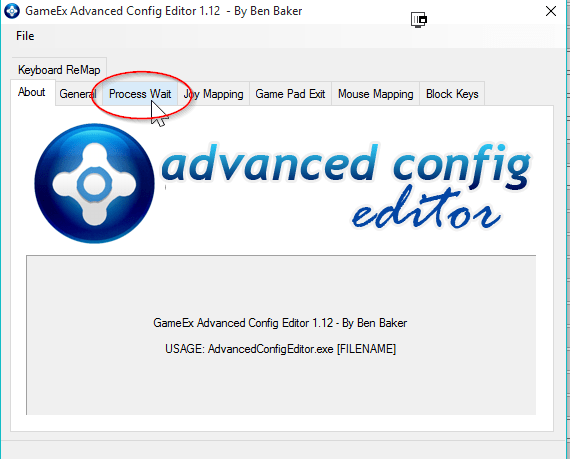

While this is old, I think that the setup info in this thread is still valid. Pay special attention to this suggestied fix for an issue that sounds like what you are reporting.
You will have to go to your Advanced Emulator Setup via Setup Wizard and click on ... next to Advanced Config
post-5872-0-86515400-1440892544_thumb.pn
When Advanced Config Editor opens, click on the Process Wait tab. It is here that you will identify the process to "wait" before returning to GameEx. Keep in mind I have not played with this much so others may need to contribute input.
post-5872-0-62182200-1440892702_thumb.pn post-5872-0-85282000-1440892692_thumb.pn
Spot on. In the post I linked by Krakerman (here), he included an advanced emulator config for D-Fend Reloaded. So download that zip file, extract the contents, and put the file (DosBox.ini) in the following directory: \GameEx\CONFIG\EMULATORS. Now open up the Setup Wizard, navigate to the Advanced Emulator Setup screen for D-Fend Reloaded, go to the field Draco describes above, and there you'll find a new entry called DosBox. Select that. Bada bing, bada boom. I believe that advanced emulator config should still be applicable for current versions of DOSBox.
