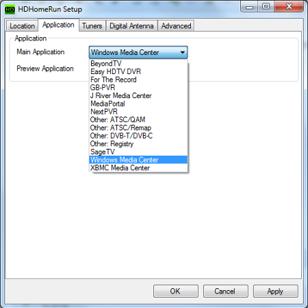

Hmm ... Still experiencing similar results as before.
I've tried a few different main application settings in the application tab of the HDHomeRun Setup, but thus far have been unsuccessful in striking upon a working combination.
