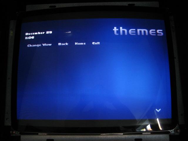

I have enclosed a picture. Those faulty themes starts all a the Themes page, the menu on top is scrollable but any action will just loop back to the same page. As you can see the screen is quite empty also.
What I would like to do if possible is to delete all faulty themes manually and then re-install them. How do I need to proceed in Gameex folder tree to do that??
Thanks

I have tried to manually install a new theme and still the same issue. When I select the theme in the Wizard then the theme is not loaded at the 'Start' page but at an empty page called 'Themes'. Any action on controls will just do nothing...

No I am not running in Arcade VGA mode. I just tried to load a low res theme after switching resolution manually from desktop (with Avres icon tray) and confirm it is giving also troubles.
I do confirm that most of the themes of my list are not working (most of them running at 640x480) and will only display a blank 'theme' page and that's all
Here are the themes not working :
Default - Media Center
Default - Media Center Background
Default - Default
Default - Arcade VGA Low Res
Simple Mode ArcadeVGA (third party theme)
Default Blueglass, Default Media Center V1, Default Media Center Background V1, Default Alpha Blue, Olive and Red are properly working
