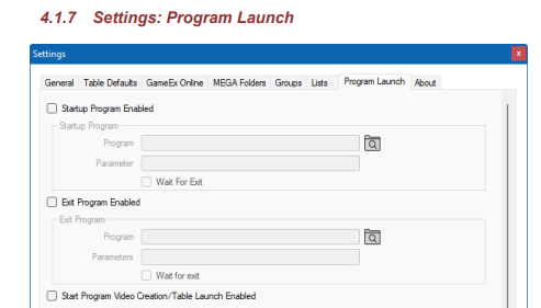

  5. Hi Mike, I did check the available documentation, but the DBM manual is dated September 2022 and does not contain any information on the differences between using PBX vs. DBM recording modes, and the tab "Media Recording" is not shown in the manual at all, that's why I was struggling a bit with the differing behaviour between the settings. Is there a more current manual available somewhere? Anyway, thanks a lot again for your help and your great software, very much appreciated.

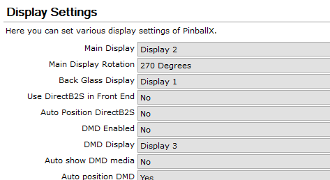

  8. Hi guys, thanks for getting back to me! PinballX.ini and logfile attached. Mike, I already switched the displays in PinballX and everything is displaying in the correct spot when launching the program. Please see screenshot of PinballX settings and Windows display preferences. It's only when recording that I get the videos mixed up and also upside down, even though from the log and the ini it looks like theroretically it should match? (Backglass is display 0 and Table is display 1, idx=0 recording to Backglass Videos and idx=1 recording to Table Videos?) Any idea where the hiccup might be? Or is there a possibility to alter the syntax of the ffmpeg commands? Thanks a lot, Manuel PinballX.ini log.txt
  9. Hi guys, running into another strange issue, I originally set up my pincab with playfield monitor as display 1 and backglass monitor as display 2 in Windows, but on numerous occasions (after unplugging the primary monitor) Windows would switch the order of the displays, which was cumbersome to correct with registry edits etc. So at some point I decide it to leave it in that order (so 2-playfield, 1-backglass) and simply switch the output displays in VPX (Screenres) and PinballX settings, which worked fine for the software, even for the PUPpacks and Virtual DMDs etc. The only issue I now have that recording videos from Game Manager or Database Manager results in the playfield video being placed in the Backglass Videos folder and vice versa, and both videos are rotated by 180 degrees. Can I edit the settings for video recording somewhere? I have tried looking in the settings for PinballX and Database Manager and found no solution yet. Thanks!
