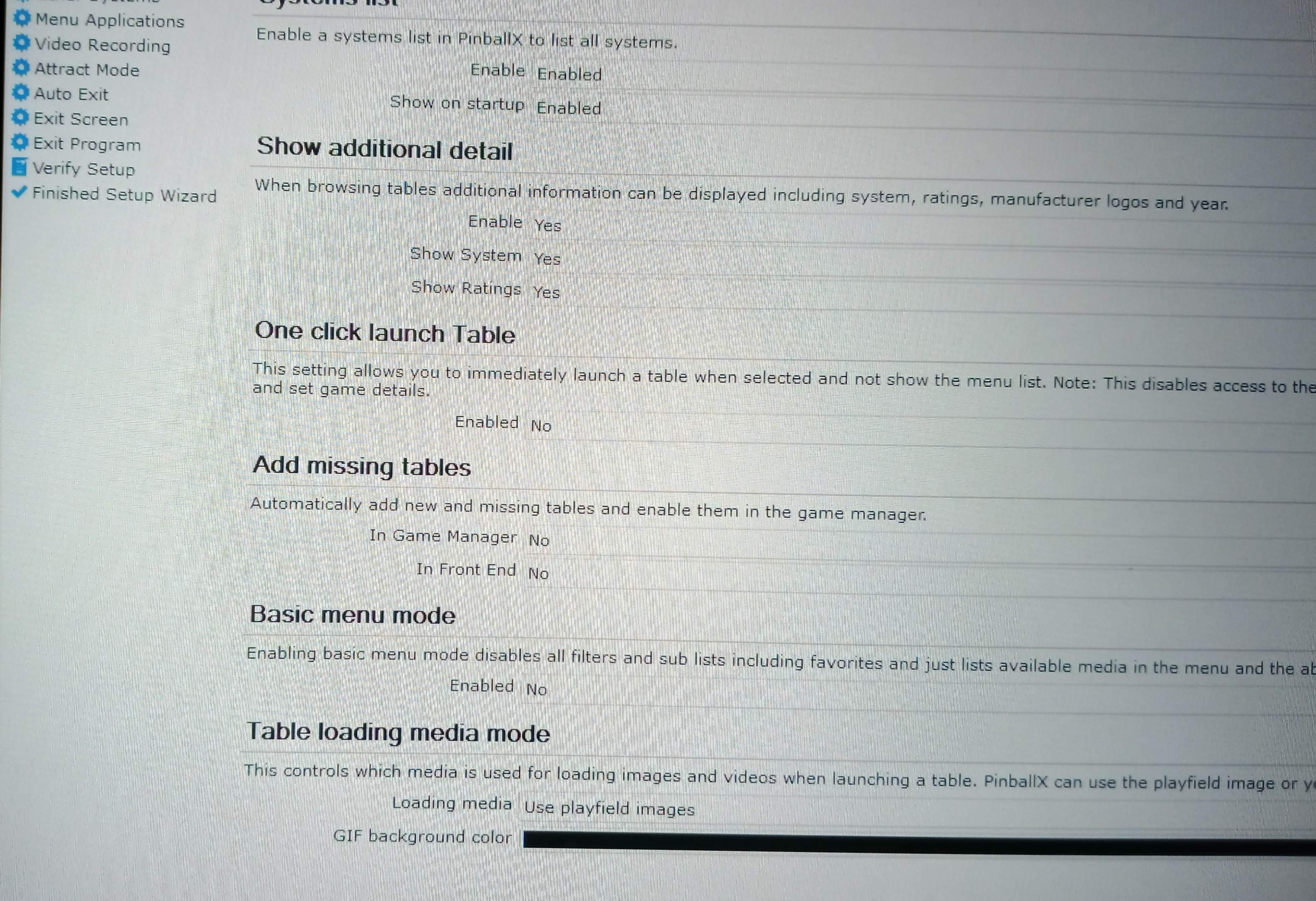

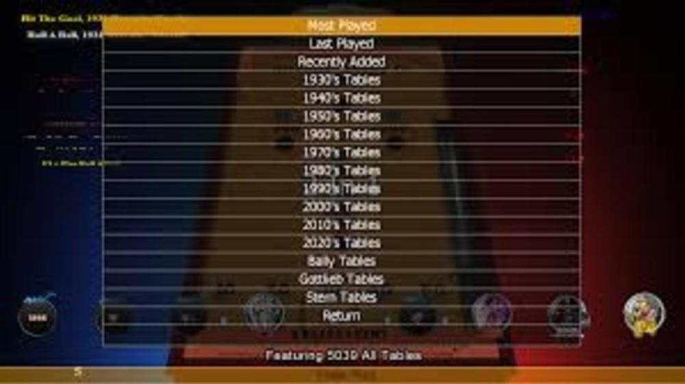

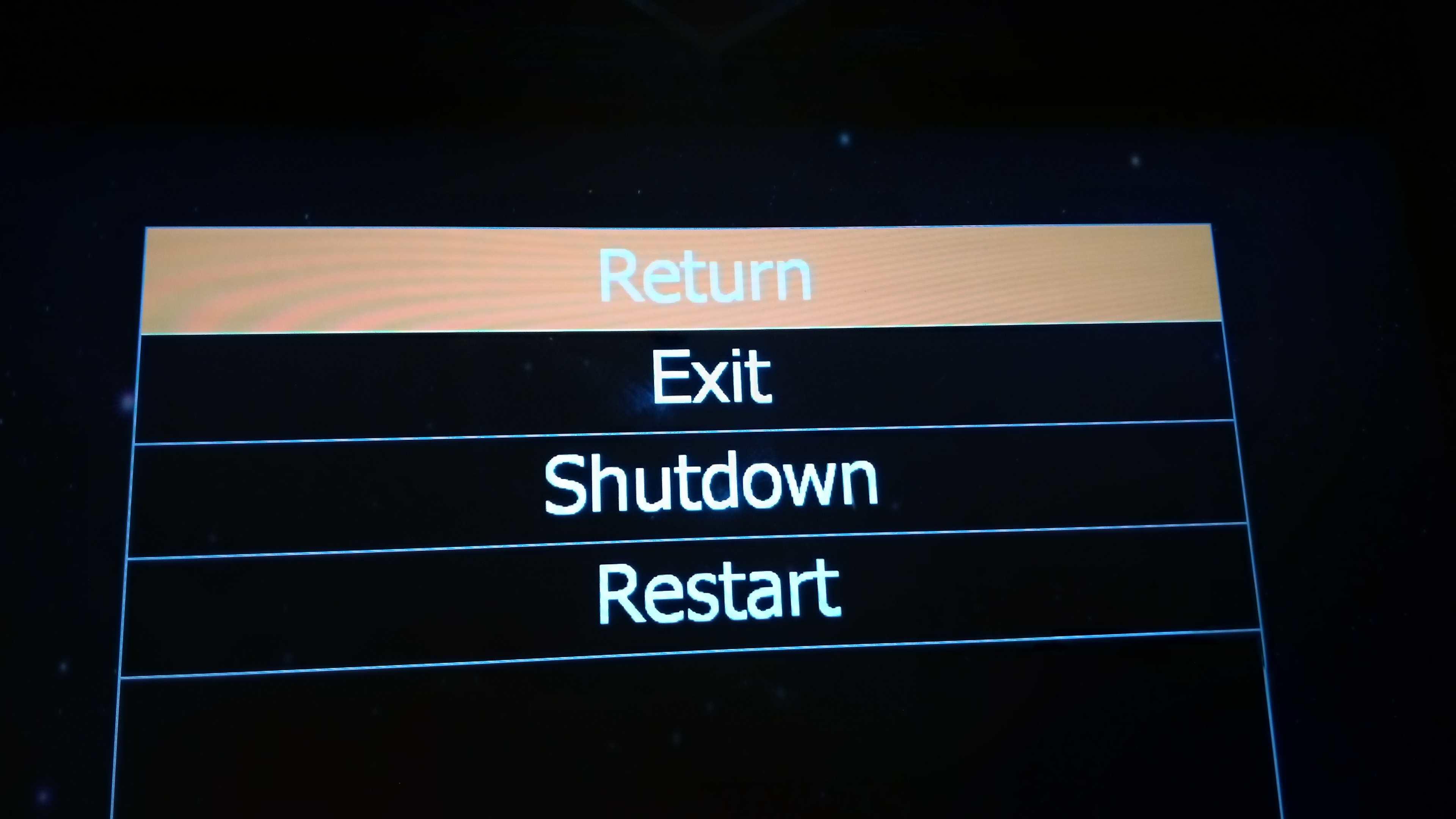

Almodo had the most liked content!

  7. Thank you very much for your quick reply, but please what do you mean by "First you habe basic mode enabled."? --> As you can see I have it "not enabled" (as it should be, right?). Also, the "system list" is enabled. See, that's the problem: I have everything enabled and still nothing, that's what baffles me... (and of course I read the documentation!) 🙂 Any more suggestions, maybe?
  8. Hi everybody, Maybe I'm the only one with this problem, but after spending literally hours trying everything i'm close to giving up. Please, how do I get to activate or see these filters in the tables select menu, like "1980s Tables" or "Lists", or "Instructions" etc.? (see third photo I found online) No matter what I click in the settings (see the first two attached photos) everything I get is "Return, Exit, Shutdown, Restart". That is it. As you can see I deactivated "Basic menu mode" and also "One click launch table", and every combination of "yes / no / enabled / disabled", to no avail. As I once mentioned in a similar post long ago, that's what it was always like for me when using PinballX - I never ever got to see these! Of course I'm running the latest version 7.0. Please for the life of me, how do I make them visible? Any help is deeply appreciated. Thanks in advance as always! PinballX.ini
