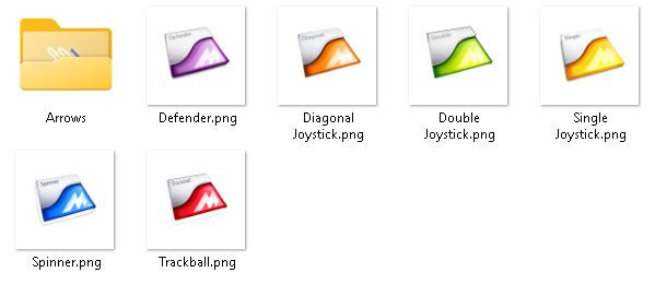

  11. Image of my images attached - I put those into C:\GameEx\THEMES\Default - Default\MEDIA\LOGOS. Video attached too - all lists except "All Mame Games" are custom lists. You can see that they load the relevant image with the same name as the list. Just have to have the entry in gameex.ini set correctly. Don't really know what those ini entries do but works as I want it to. GameEx is great but lots of the great functionality is sparely documented. e.g. Working on a plugin at the moment to handle plugging in my custom control panels and provide information back to the user - trickly to build the plugin based on the documentation. Worked out most of it but I am trying to work out if I can trigger a game list update or an exit of the gameex app but stuggling to work it out. I guess it should be possible to use GameExEventQueue.Add() to send a command but can't find any docs on what commands are available. Custom Lists.mp4
  12. For anyone that stumbles on this thread, I figured it out. I update a setting in gameex.ini from "Snap" to "True". After that it display icons in the theme's logos folder with the same name as the list item. [LIST_SETTINGS_8] displaybackgroundimage=True
