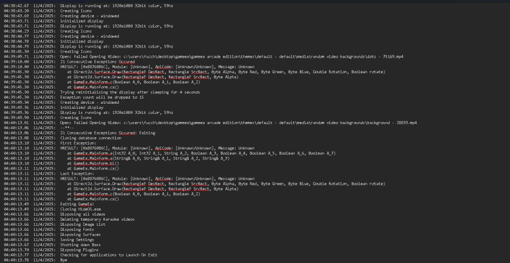

  4. For the most part GameEx arcade runs great for me and has been for a few years now. About once a week or maybe longer it encounters an error and crashes. Just wondering if somebody could help me out with fixing this. I feel like I might see where it's happening but not sure what to do about it. Thanks for any help. I tried attaching a text file of the crash log to this post but get Error code -200 So I attached an image of the end of the crash log.
