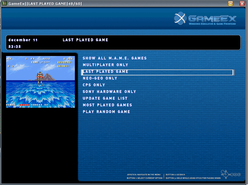

The start page:
I'm missing items. Favorites and exit are missing, and they are both enabled.
And I can't get windowed mode to work at all. I enable it in configuration, then run GameEx (which then opens in fullscreen) and when I re-enter configuration, it's set to Fullscreen. Somehow, it magically changes back. I've tried and tried. But will try again.

See attachment for how the start page looks (exclusive peek on my theme! )

Very strange about the start page. Not seen that before. Post your gameex.ini and Ill take a look.

I just tried 5.29 with the start page issues remaining.
My .ini is attached.
Emph
Try these changes (seperatly)
Change Show Start Page First to Enabled
Change Font Size to one of the new valid values, -1 is no longer supported. Try -2 or -3
Also try using one of the predefined languages instead of custom.
Let me know which one fixes it.
Okay, first I tried enabling "show start page first". This didn't work. I went into the last shown page in this case "ALL Mame Games". I then pressed my start page button and the same problem, no favorites nor exit.
Next I tried with the font size. Not solving any problems either. I didn't see much difference with smaller and smallest (I'm running GameEx in 800x600).
Last, but not least I tried changing from custom to English. Voilá, Now I can exit, but still no Favorites. I then edited my custom inputs so that my blank fields now had " " in them (as you had told someone else in another post) and my custom text now works.
I did all of this through your configuration app.
I then opened up my .ini in notepad and everything seemed to be changed accordingly.
I did all this in 5.29.
Emph
