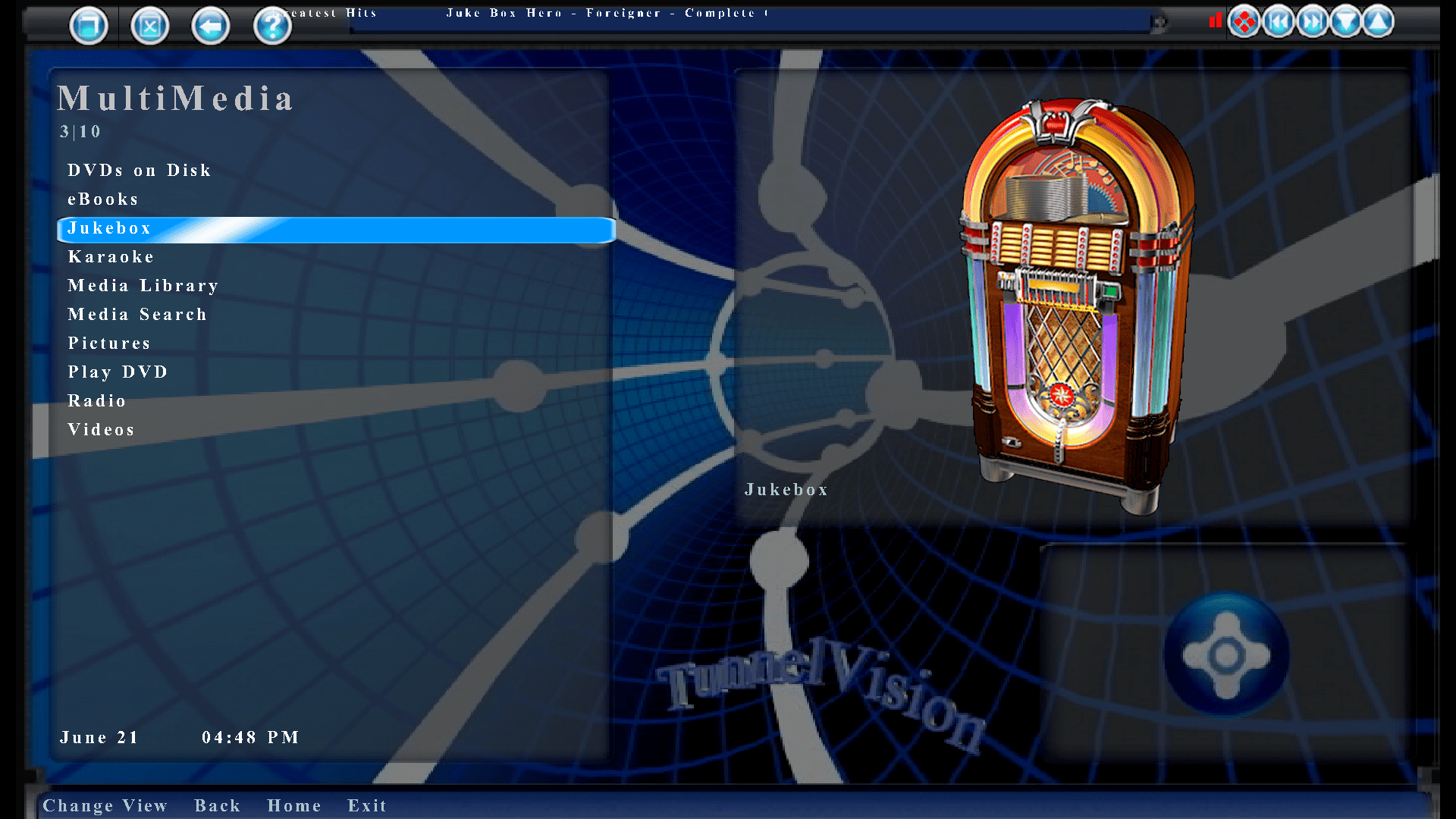

Does anyone know of a way to change the scrolling Jukebox song description test from the default location? I am finishing up the TunnelVision theme and making it a 16:9 theme (looks good even in 1920:1080 now), but the infuriating scrolling text is bleeding over onto my outline at the top at 1280:720 resolutions or higher. Any help would be appreciated. Thanks.

I've asked Tom about this before (in Feature Requests) because it's slightly off centered in 4:3 which makes things look a little bit less polished looking. If i remember correctly HK said you cannot adjust it in the theme editor. Hopefully Tom will make it adjustable.

Its supposed to move the Jukebox text up when using higher resolutions. No better?
Ohhh, okay. Thanks Tom, but for the theme I am working on it isn't what I meant. In this case the text scrolls too far to the left outside of the center text bar where it is supposed to be (or where it was on the 4:3 resolutions). What is really needed and would be great would be the ability to move the scrolling text field to appropriate places when making a theme, in the text editor or referenced in the ini.
I am about to put up the TunnelVision theme in 1280x720, I was hoping there might be a way to fix that field beforehand though. Thanks
I will look into it. Can you post a screenshot so I understand?
