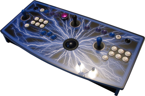

Player 1 will have a 7 button layout; I will also have a spinner with 2 buttons and a track ball with 3.
My question is, should I link button 1 player 1 to button 1 on the spinner and button 2 player 1 to button 2 on the spinner?
I would also link button 1 player 1 to button 1 on the trackball etc...
The reason behind this would be that I would not have to configure as many games in mame to use certain controls with games that are setup to use certain controls. The downside to this as I see is less customizable options and what I mean by that is this. If I would decide to play PSX, a game that used all 8 buttons I would not be able to link to a close button if it was already hard linked to another.
To give you an idea of what my control panel layout will look like, I have attached a picture.
Thanks.

I plan on using a IPAC2 if I link and a IPAC4 if I don't link, it is not built yet.
The default setup for the CP above is the following.
Player one joystick and the 4-way joystick are linked together, does not apply if using U360s (duh).
Player1 button 1 and 2 are linked to the two buttons to the left of the spinner.
Player1 button 3,4,5 are linked to the three buttons to the right of the 4-way.
Player1 button 6 and 7 are linked to the left side pinball buttons.
Player2 button 1 is linked to the front pinball plunger button.
Player2 button 2 and 3 is linked to the right side pinball buttons.
Buttons to the left of the trackball are the mouse buttons.
I am trying to decide if I should keep it hard linked like that or make each button have an individual press, with the IPAC4 I would have more than enough slots to do this as it supports up to 56 devices.
Thoughts?

Well it doesn't sound like it's sharing buttons that you would ever need separate, so I would probably leave it as it's default then. The only think I would want is to be able to use those 3 buttons next to the trackball for Player 1 PS2 and N64 games. I believe you could use a program like AHK to convert those 3 mouse buttons to keys anyway. But you can worry about that after you get your CP.

I have more or less decided to just make each button its own key press because once it is hard linked, the only way for me to change it is to open the CP and rewire. Without hard linking, the only think I have to do is reconfigure and I can always link buttons that way.
I beleive I am making the right choice here. :unsure::lol:
