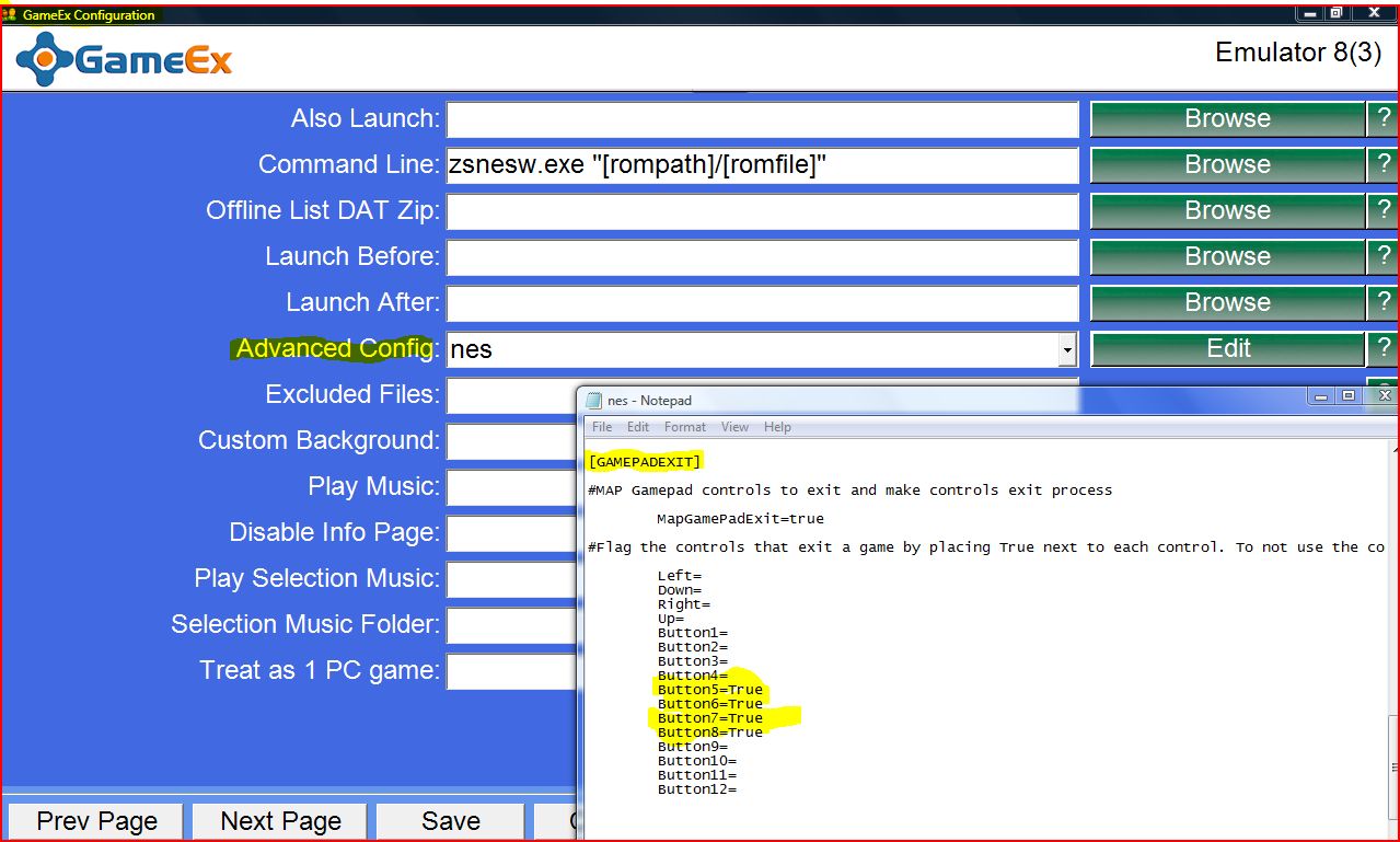

Ok if you want to exit Emulators other than MAME see the attached screenshot.

The program Im using is the GameExConfig.exe located where gameex is installed. You want to choose advanced config.
