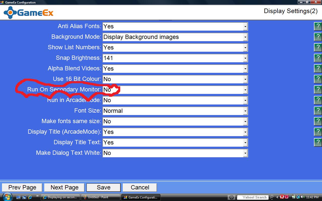

And here's the weird thing. If I take GameEx out of full screen mode (ALT+Enter), I cannot even drag the program window to the other screen - this is the only program I have ever had that problem with. Including games. It just stops at the edge of the computer monitor. I have selected / deselected the option to use the secondary monitor in the GameEx configuration program, but with no luck.

I tried that with both options, and no effect. Every time I ran GameEx it appeared on monitor 1 only.
