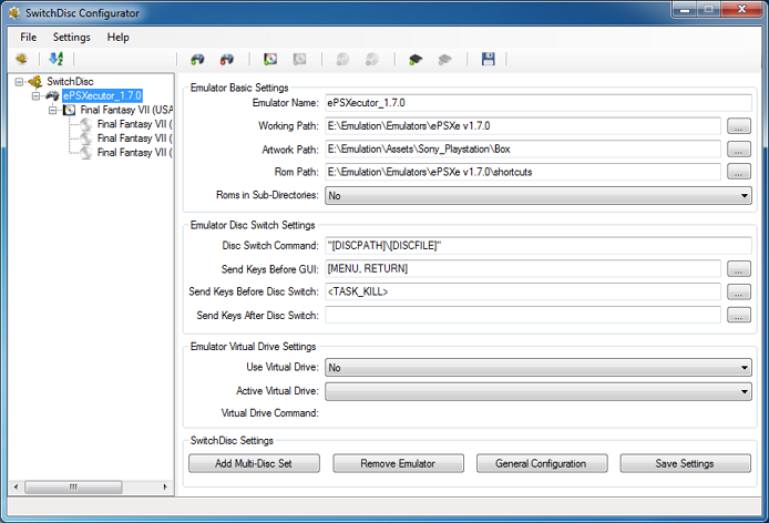

@Felix: In testing this latest build I put together a SwitchDisc config that works with ePSXecutor. Note that I'm not using a virtual drive with this config. If I were, I'd need to throw in an additional disc mounting step. That would be fairly arbitrary to do, but it is noteworthy. All in all, it turned out to be a pretty simple config (especially once I leveraged the new Task Killer operation :D). I've attached the config for your perusal, but a picture is worth a thousand words. Here are the pertinent settings for ePSXecutor:
If something in here doesn't seem clear you can refer to the full config, or you can post back right here. I'll post up a working GameEx config for this tomorrow evening.
Thanks again to Felix, Adultery, and to anyone else who's had the opportunity to mess around with this utility.

Okie Dokie, config time. Note that what I'm presenting here is probably one of at least a few different ways you could pull this off. First here's my full ePSXecutor emulator config from GameEx:

Here are some noteworthy tidbits from that config. I've utilized batch scripts here in an attempt to more closely mirror you're own processes. If I'd had my druthers, I'd probably attempt to omit that step, and just run/exit SwitchDisc directly form the Launch Before and Launch After parameters (technically you could still do this by launching everything else from Also Launch, but for now we'll stick with the script)
You're absolutely correct that the command that should be "Launch Before" must be launched as an "Also Launch". I suspect that if one were able to use the start "" "process.exe" notation GameEx would be able to process the command a bit better, but since we're sending multiple parameters into that batch file and they all potentially contain spaces (which in turn causes the start "" "process.exe" to balk), we'll just stick with the Also Launch command. It works fine for our purposes.
Also Launch:
"E:\Emulation\Emulators\ePSXe v1.7.0\batch\ePSXecutor_Also_Launch.bat" "[WORKINGPATH]" "[ROMFILE]"
The start "" "process.exe" method works just fine for Launch After though, so that's what I'll use here.
Launch After
start "" "E:\Emulation\Emulators\ePSXe v1.7.0\batch\ePSXecutor_Launch_After.bat"
So what exactly do those batch scripts contain? Well let's take a look! Take note of how the last line in ePSXecutor_Also_Launch.bat utilizes the parameters passed in from GameEx.

Switchdisc config:
<?xml version="1.0" encoding="utf-8"?>
<SwitchDisc xmlns:i="http://www.w3.org/2001/XMLSchema-instance" xmlns="urn:SwitchDisc">

<DefaultArtworkPath>E:\Michael\GAMES\My Games\All Games (Files)\PSone\ePSXe Emulator\ePSXecutor frontend\SwitchDisc-1.0.0\SwitchDisc-1.0.0\images\DefaultDiscImg.png</DefaultArtworkPath>
<VirtualDrives i:nil="true" />
</ApplicationSettings>
<Emulators>
<Emulator z:Id="i1" xmlns:z="http://schemas.microsoft.com/2003/10/Serialization/">
<ItemID xmlns="http://schemas.datacontract.org/2004/07/">emu-1</ItemID>
<EmulatorName>ePSCecutor_1.7.0</EmulatorName>
<WorkingPath>E:\Michael\GAMES\My Games\All Games (Files)\PSone\ePSXe Emulator\ePSXe 1.7.0</WorkingPath>
<ArtworkPath>E:\Michael\GAMES\My Games\All Games (Files)\PSone\Artwork\Cartridge</ArtworkPath>
<RomPath>E:\Michael\GAMES\My Games\All Games (Files)\PSone\ePSXe Emulator\ePSXecutor frontend\Game Shortcuts</RomPath>
<RomsInSubDir>false</RomsInSubDir>
<SwitchDiscCmd>'[DISCPATH}\[DISCFILE]"</SwitchDiscCmd>
<KeysBeforeGUI>[MENU, RETURN]</KeysBeforeGUI>
<KeysBeforeSwitch><TASK_KILL></KeysBeforeSwitch>
<KeysAfterSwitch></KeysAfterSwitch>
<UseVirtualDrive>false</UseVirtualDrive>
<VirtualDrive i:nil="true" />

Last thing: Off topic
You said you are running win 7 x64. Are you running NullDc? If so, what version? I can run 1.0.3 but 1.0.4 has a dll error and refuses to load the video plugin. I've installed the C++ runtimes and reinstalled direct x drivers and nothing seems to allow newer versions tor run (the ones with the peruperu controller plugin and better video plugins). The peruperu plugin does not show up in my list of selectable controller plugins even though it is in the plugin folder, I may have copied it from the newer version's folder hoping it would work, but can't remember doing that.
Link to comment
Share on other sites
If it makes you feel any better I myself have struggled with Launch Before and Launch After parameters on a couple of different occasions (and once even specifically with ePSXe). It can definitely be frustrating, but it’s not insurmountable.
Null:
Quick questions:
1) Are you still using the ePSXe settings above? I have not looked into the Daemon Tools and associated commands. What are they and do you think I should use them?
2)Do you think I should try going back to the batch file for the launch before and adding a 5 second timeout, like you did here to give ePSXe a chance to start and the ePSXecutor config a chance to see ePSXe? Maybe this is our Ninja Gremlin :ph34r:?
:: Launch ePSXeCutor using the [ROM] parameter

OK I may have made some headway with this issue. I downloaded SwitchDisc from this thread to my alternate PC. I setup a new emulator config for ePSXecutor in GameEx. I copied the Advanced Emulator Config from this post. I made a couple of tweaks to the Switchdisc config seen here. And guess what? Everything launched just fine, but when I exited the emulator my Launch After command did not run as expected (it didn't run at all)!
So I took a couple steps back and I reverted to the Advanced Emulator Config from this post. Then when I exited the emulator ... everything worked! (i.e. the Launch After command worked as expected) :huh: turns out that the experimental changes I made to the Advanced Emulator Config weren't superfluous at all, and in fact they were what enabled full functionality. That was certainly a piece of dumb luck! :o If you haven't done so yet, I'd go ahead and overwrite the ePSXecutor SwitchDisc Advanced Emulator Config with those settings.
Other than that, everything is working as expected.
Here are the details that are fit to print using the config on the secondary machine:
[Console] Sony Playstation (ePSXecutor)
[Emulator]
Enabled=True
lastgame=
VideoSnapPath=E:\Emulation\Assets\Sony_Playstation\ePSXe\Video_MP4
CDCheckFile=
CDCheck=False
RandomMostPlayed=True
ShowMostPlayed=True
PlayInScreenSaver=False
GamesIn7Zips=False
PCGame=False
SelectionMusicFolder=
PlaySelectionMusic=False
DontShowInfo=False
PlayMusic=False
CustomBackground=
ExcludedFiles=
LaunchAfter=start "" "E:\Emulation\Utilities\SwitchDisc-1.0.2\SwitchDisc.exe" -q
LaunchBefore=start "" "E:\Emulation\Utilities\SwitchDisc-1.0.2\SwitchDisc.exe" -w "[WORKINGPATH]" -f "[ROMFILE]"
AlsoLaunch=
Debug=False
ShowDesktop=True
RemoveBrackets=True
Capitals=False
ReplaceUnder=True
ReplaceDash=False
SendKeys=
WaitBeforeKeys=
MapKeys=True
WorkingPath=E:\Emulation\Emulators\ePSXe v1.70
ControlPanelPath=E:\Emulation\Assets\Sony_Playstation\ePSXe\Controls\Console_Sony_PSX.png
ManualPath=E:\Emulation\Assets\Sony_Playstation\ePSXe\Manual
CartPath=
BoxPath=E:\Emulation\Assets\Sony_Playstation\ePSXe\Box
TitlePath=E:\Emulation\Assets\Sony_Playstation\ePSXe\Title
SnapPath=E:\Emulation\Assets\Sony_Playstation\ePSXe\Snap
RomPath=E:\Emulation\Emulators\ePSXe v1.70\shortcuts
MapFile=
configFile=[Mapping On] ePSXecutor SwitchDisc (Process Close)
DATABASE=[Console] Sony Playstation
ROMFilter=*.lnk
Command="[ROMPATH]\[ROMFILE]"
StartPageLogo=Sony Playstation
STARTPAGENAME=[Console] Sony Playstation (ePSXecutor)
TITLETEXT=Sony Playstation
UseDbName=True
MusicPath=
TVAdPath=E:\Emulation\Assets\Sony_Playstation\ePSXe\Video_Advert_MP4
CustomArtName1=Print Advert
CustomArtPath1=E:\Emulation\Assets\Sony_Playstation\ePSXe\Advert
RomsInFolders=False
MergeSets=True
CustomArtName2=Disc
CustomArtPath2=E:\Emulation\Assets\Sony_Playstation\ePSXe\CD
SwitchDisc.xml

runitgame.bat
chcp 65001
E:
CD "E:\Emulation\Emulators\ePSXe v1.70"
start "" "E:\Emulation\Utilities\SwitchDisc-1.0.2\SwitchDisc.exe" -w "E:\Emulation\Emulators\ePSXe v1.70" -f "Final Fantasy VII (USA) (Disc 1).LNK"
"E:\Emulation\Emulators\ePSXe v1.70\ePSXeCutor.exe" "Final Fantasy VII (USA) (Disc 1)"
Regarding the runitgame.bat, my previous statement about the emulator command was wrong. Looks like the ePSXecutor game shortcuts do launch ePSXecutor using a reference to the internal game config. Sorry I hadn't realized that before!
Any hoo, I'd definitely recommend updating your Advanced Emulator config if you haven't done so. There's a slight discrepancy in the way we've got directory paths configured too. I've got my ePSXecutor shortcuts stored in a separate directory that ePSXe and ePSXecutor
I think you mentioned that your shortcuts are in the same directory as ePSXe.exe and ePSXecutor.exe, but maybe you should try separating them into separate diectories? Then point your Working Path at the directory containing ePSXe.exe and ePSXecutor.exe and point your ROM directory at the directory containing the shortcuts. Our SwitchDisc commands are identical so I really think you should be good to go there.
There's one other thing that's likely going to trip you up (when you get so far as changing discs):
You'll want to change that command so it's completely encloses in double-quotes (the first one is a single quote).
