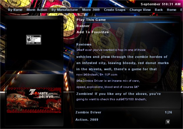

There is also a slight issue with the description, you don't seem to be handling quotes, I've attached 2 screenshots, they are coming through as “
One last thing, you are grabbing the reviews, although the reviews are useful would the 'About the Game' and the 'Key Features' not be more useful

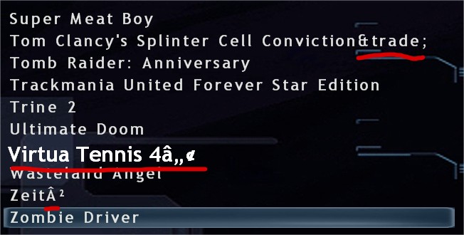

Text is being displayed a bit weird in places on the game list screen, see attached screenshot

It looks like there may still be some minor issues with markup characters in game titles and descriptions, but nothing like what Stu was showing above.

This is so cool! All the text markup that I can see has been addressed and displays correctly. The game info looks awesome. Only weird peccadillo is that Monkey Island 2: Special Edition is still not displaying. All the other previously missing games are now displaying.

Description scrapping instead of reviews - Tested and fixed

Weird Text - fixed
All the markup appears to be fixed but I'm still seeing the odd large font in the games list (see the original screenshot of Virtual Tennis) there are a couple of others I noticed this morning before work but the only one I can remember is DarkSiders (50620)
