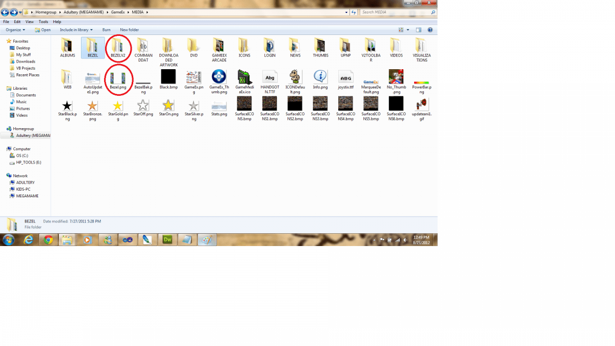

Hi Guys,
I have custom bezels, in the media/bezelv2 folder (mame.png) etc and I can't get them to work in games (always black).
Turned on in options, but has never worked. any pointers? (Im happy to have the same bezel for all games
cheers
V
I think they go in the MEDIA folder and not the Bezelv2 folder.
The correct path is \GameEx\MEDIA\BEZELV2 and you have to name the bezel mame.png for it to show. If you want to rotate the images that show, you can use a program by Tempest called The Randomizer to do so.

Humor me and put a copy in the MEDIA folder, and make sure your bezel.lay file is in the BEZELv2 folder. I have my bezel in both folders but I'm fairly sure the one you're using goes in the MEDIA folder.
ok, still having issues,
Still no mame.ini, no mameui installed... simply gameex and mame 146
(I have however found [Arcade] Arcade (MAME).ini (only file found when doing a full hdd search on mame.ini) which I assume is the file in question since gameex is controlling it?
Also tried putting the mame.png in the media folder. Clearly its the ini file thats the issue here I just can't find it :(
