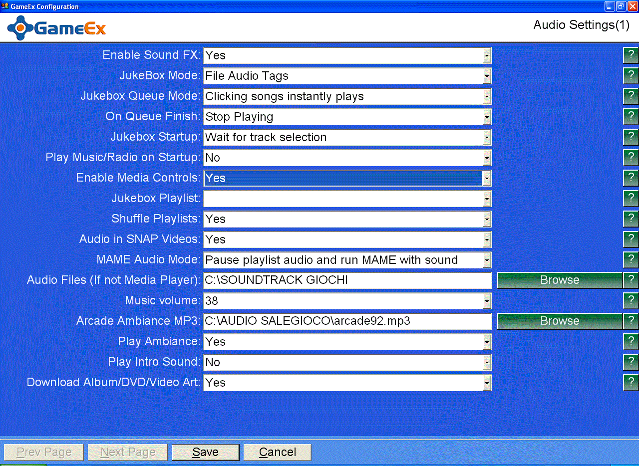

When I start gameex, the arcade ambiance also starts with the tune that I have selected. When I enter in the juke box, the arcade ambiance stops and it doesnâ??t start more.
Is it possible restarts the arcade ambiance when I exit from the juke box or when a juke boxâ??s music finishes? How must I change settings?
(I report current settings in the attachment)
Thank you

Hi :)
When I start gameex, the arcade ambiance also starts with the tune that I have selected. When I enter in the juke box, the arcade ambiance stops and it doesn't start more.
Is it possible restarts the arcade ambiance when I exit from the juke box or when a juke box's music finishes? How must I change settings?
Thank you

I would definitely recommend upgrading to the latest version of GameEx regardless. We no longer support issues through the use of the Advanced Configuration utility and now support only through the Setup WIzard which is superior and evolving.
The issue to which Simba was referring involves using the arcade ambiance files (for which there are a few available from different sources) by pointing to a directory and randomly selecting from the various files in that directory.
I think that the reason Arcade Ambiance is halted is that, in most cases, the user wants to hear the music selected vs. the ambient sounds of an arcade at the same time. You may wish to go to the Pinned Topics forum and submit a Feature Request to have this added as an option to automatically re-enable Arcade Ambiance once the music has stopped playing in Jukebox (either end of song or by manual stop).

Sometime emus mess up the sound. You should hopefully be able to fix this by setting the option to disable sound for the emulator.
Let me know if it does not work.
Also I think if you set the appropriate audio setting for music to stop once the playlist is finished Ambiance should start up again.
