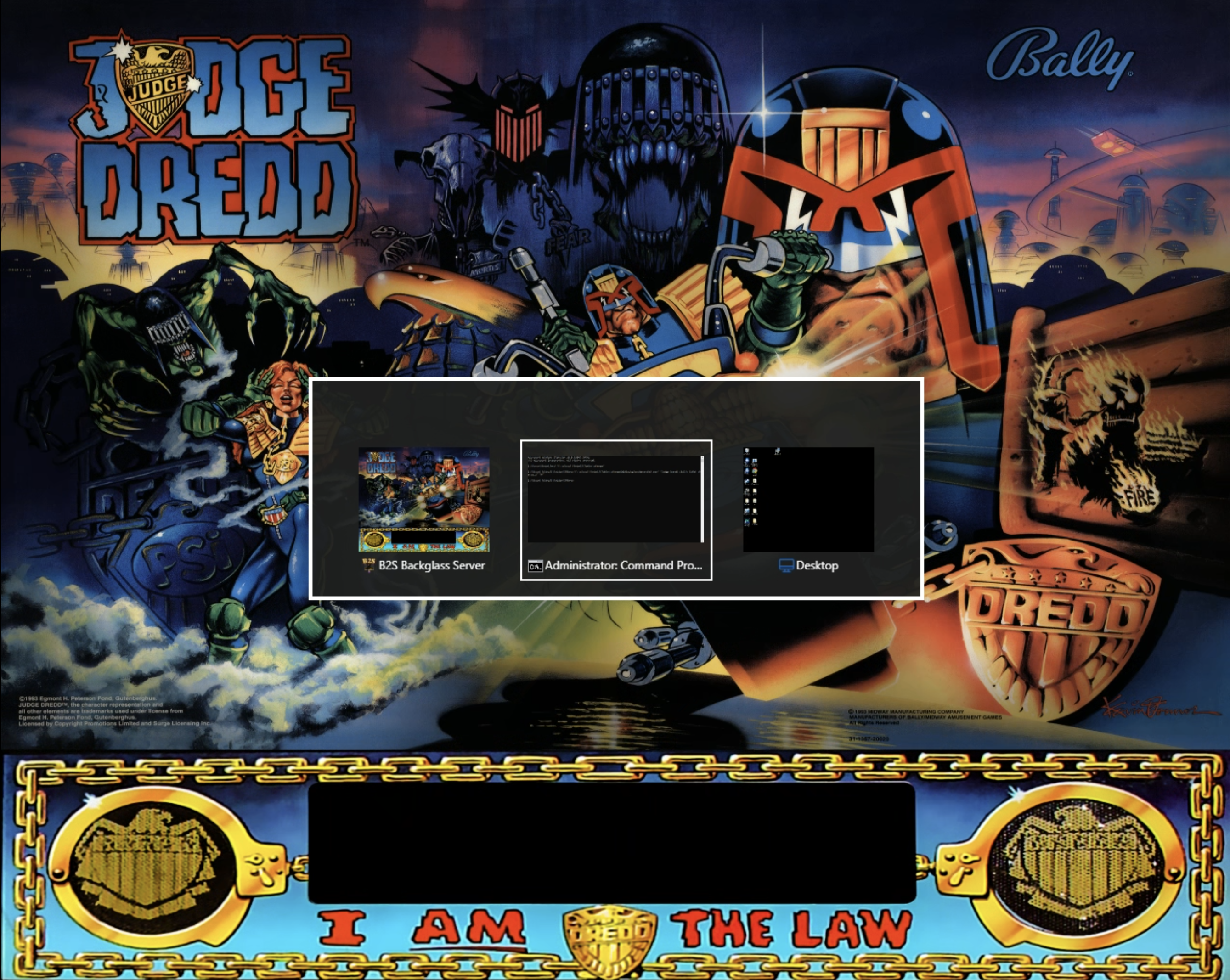

  11. ALT+TAB when PinballX open - no B2S window open. Also nothing in Task Manager. Running command prompt, absolutely fine (attached)
