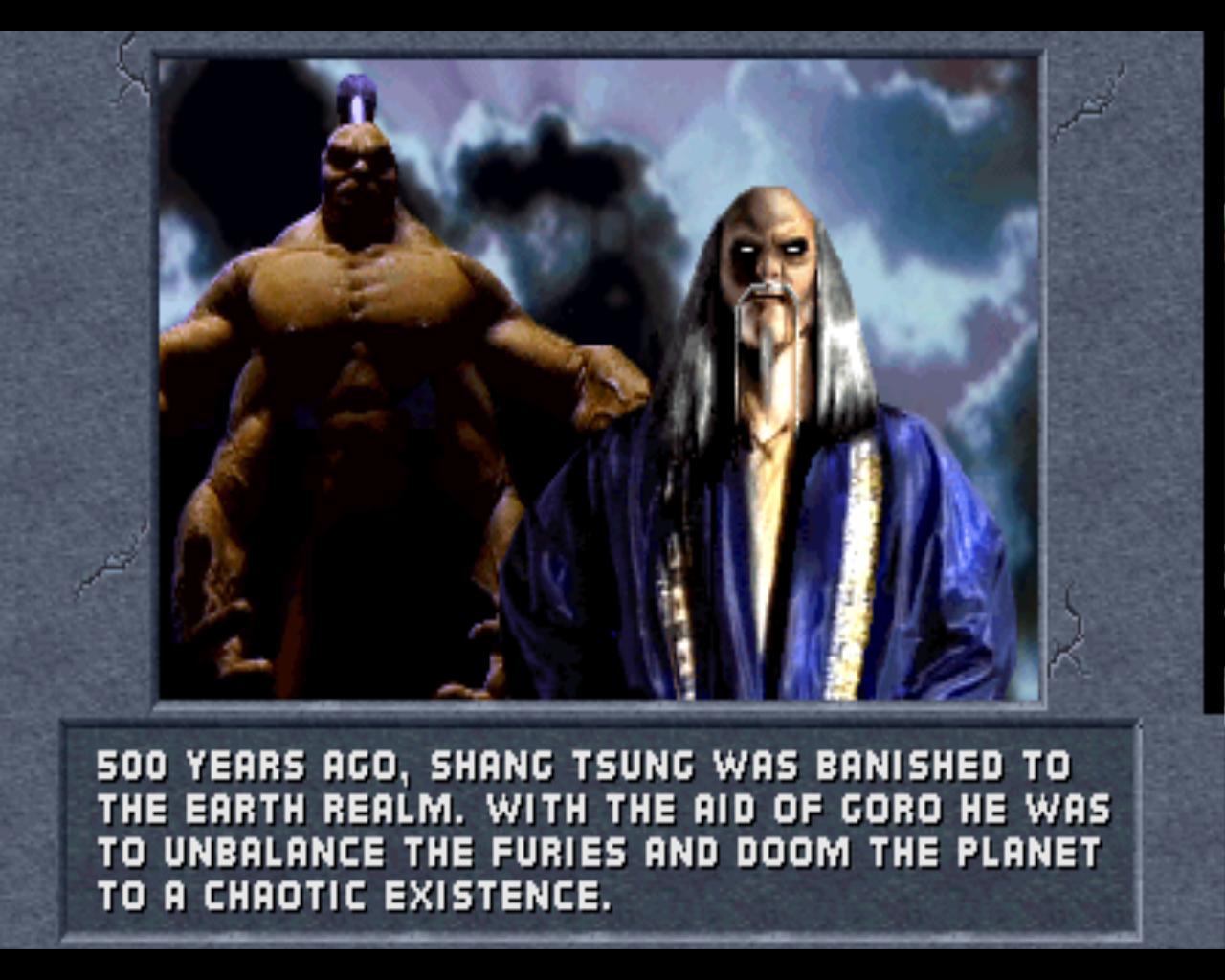

  4. I'm using the Mame32 emulator that I downloaded when I installed Gameex. About the command line I'mnot exactly sure what you mean but is it something like below? -device_video_output fullscreen -quiet -dir_rom "C:\Emulators\Mame32\roms" Besides my desktop is OK. It complete fills the screen. Also when I see Gameex in a small window it fills out the window completely. However when i switch to full screen I get the black edge. About deleting the INI file? Will mame still work. I added a screenshot. On the right and left there are also black edges but these are not on the printscreen strangly? Besides when I start games from Mame32 now the games also have this black edge. Someting isn't right maybe a full reinstallation would do the trick? It used to work fine...

  10. Since my last GameEx update the screen suddenly is cut off on both sides. I've been looking around in the forum however I cannot find a fix. Does somebody have an idea what could be the cause? I've added a screenshot http://homedrive.ziggo.nl/[email protected]%20MAME.bmp
  11. Found it! I was looking in the wrong menu. However now i have a black line on the left and bottom of the screen. It seems like it doesn't fit the whole screen. I didn't have this problem before? Where can I fixes this......
