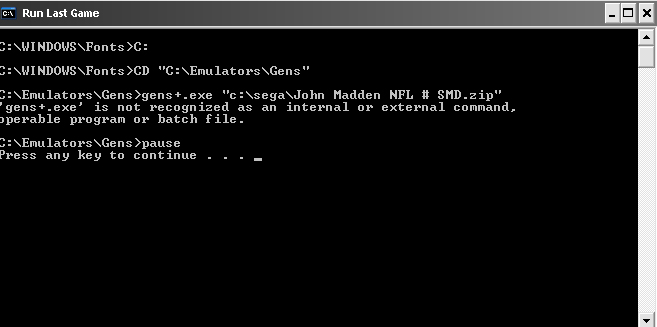

  2. I says that because I am a bad typer. attached a screen of the cmd command line

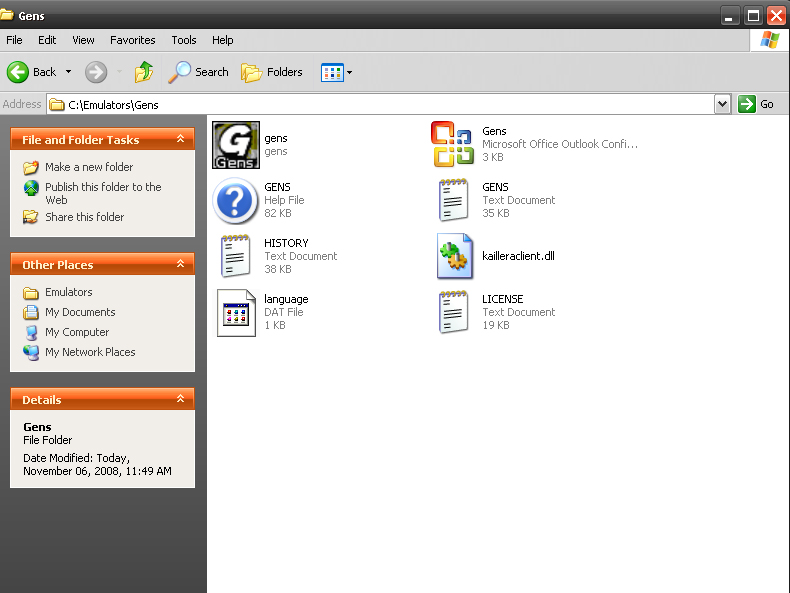

  3. Yes I let gameex download them and left them in the folder that they were downloaded into. I will attach a jpg so you can see for yourself

  7. cmd box says: c:\Emulators\Gens>gens+.exe "c:\sega\John Madden NFL # SMD.zip" 'gens=.exe' is not recognized as an internal or external command, operable program or batch file. edit: For the rom paths I typed them in and then after it didnt work a couple of times I used the browse function just to make sure I got it right, same result though.

  9. This is all that was in runit.bat: C: CD "C:\Emulators\Gens" gens+.exe "c:\sega\John Madden NFL # SMD.zip" Thanks again
