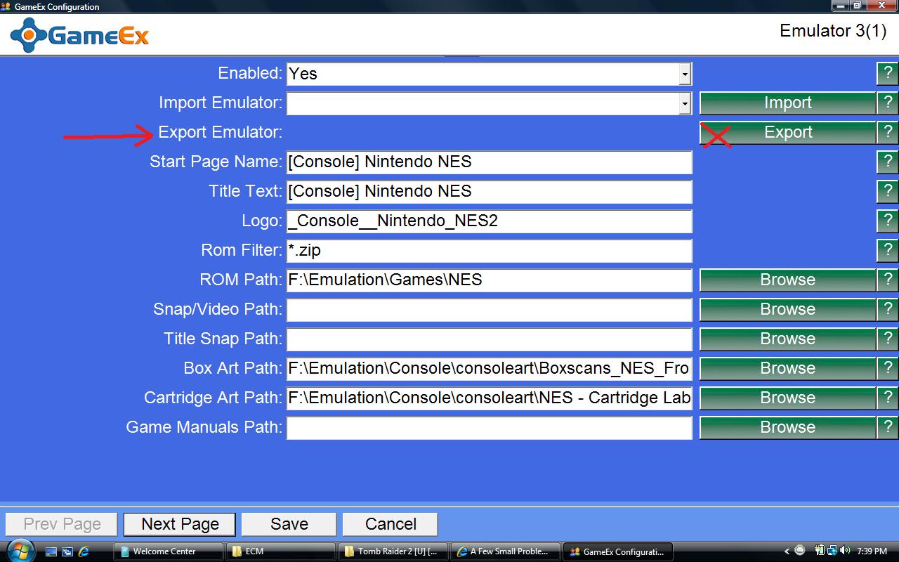

there is.. goto gameex advanced config>choose emu> Click export, Save to your desktop. Open.. Then post contents here.
[Emulator_5]
Enabled=True
STARTPAGENAME=Nintendo SNES
TITLETEXT=Nintendo SNES
StartPageLogo=_Console__Nintendo_SNES
ROMFilter=
RomPath=C:\Emulator and Roms\SNES\ROMS
SnapPath=
TitlePath=
BoxPath=
CartPath=
ManualPath=
ControlPanelPath=
InstructionsPath=
WorkingPath=C:\Emulator and Roms\SNES
MapKeys=False
WaitBeforeKeys=2000
SendKeys={ESC}
ReplaceDash=False
ReplaceUnder=True
Capitals=True
RemoveBrackets=True
ShowDesktop=True
Debug=False
MAPFile=C:\Program Files\GameEx\DATA\EMU_5.map
AlsoLaunch=
Command=snes9x.exe "[ROMPath]\[RomFile]"
OLDatZip=
LaunchBefore=
LaunchAfter=
configFile=ZSNES V6
ExcludedFiles=
CustomBackground=
PlayMusic=False
DontShowInfo=False
PlaySelectionMusic=False
SelectionMusicFolder=
PCGame=False
DATABASE=[Console] Nintendo SNES
GamesIn7Zips=False
PlayInScreenSaver=False
ShowMostPlayed=True
RandomMostPlayed=True
CDCheck=False
CDCheckFile=
[GENERAL]
DumbyValue=
You have no Romfilter defined.
Use *.zip or
*. Whatever your rom formats are in zip,smc
Try that. :)
Also Id turn off the MAP file.. If yoru roms are named with GOODTOOLS then it should match up to the DB.
Usually MAP files are to make romname SMB display Super Marion Bros.
So in essence your RomNames really dont match up to the ones in the DB
