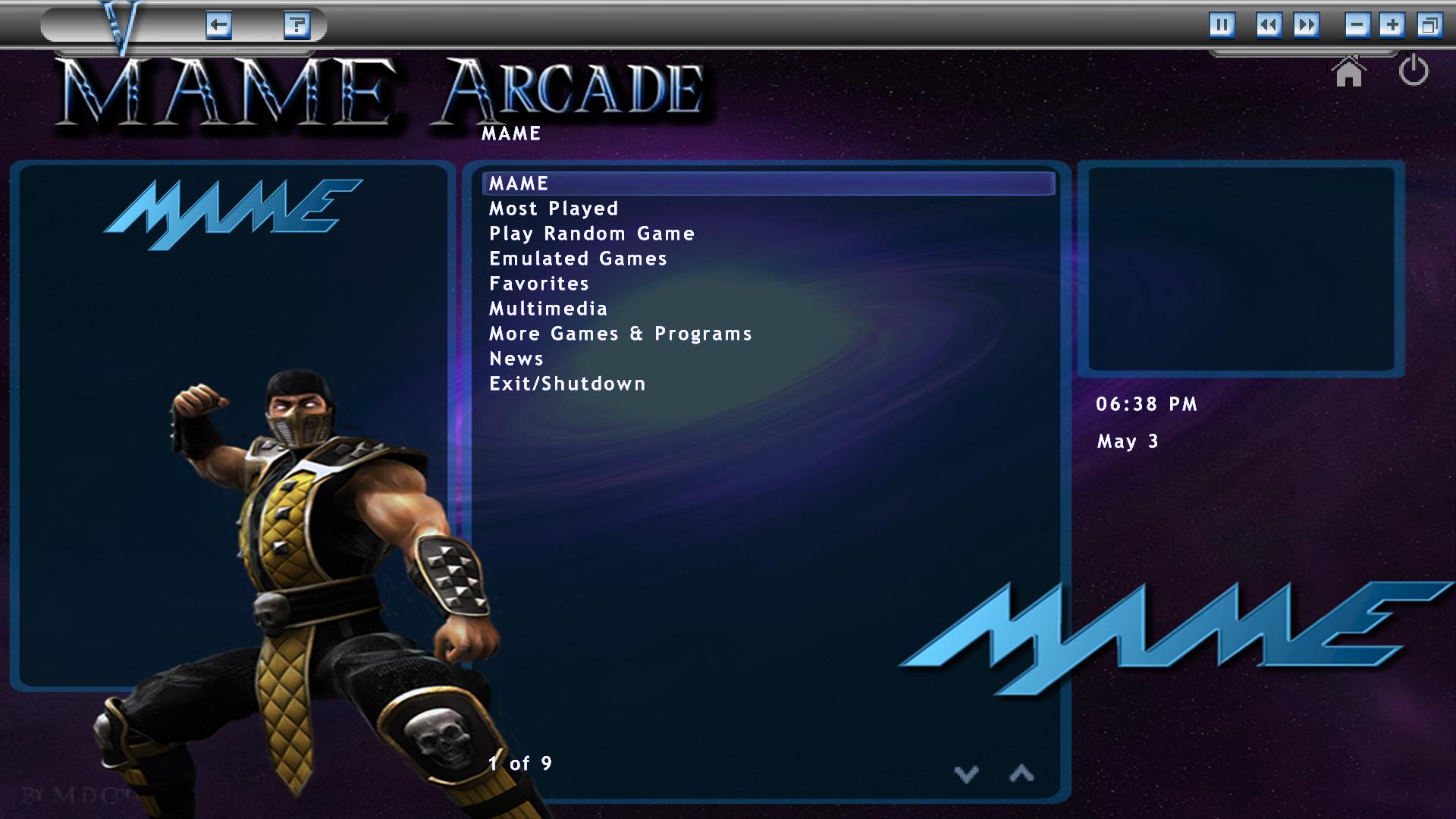

Hi Tom,
Attached are 2 screenshots taken this evening one from a backup of version 7.54 and the other from the current version 8.09, if you look at the top bar, home and exit icons and list scroll arrows and compare them at 100% zoom you will see the graphic corruption. Also I don't know if it is related but the start sound of the theme (valhalla) no longer works either also the loading screen does not display - just a black screen before theme is loaded. I have also attached my latest log file if you want to look at it. On another note is it possible to setup a working model 2 v0.4 as a separate emu? any ideas you might have would be greatly appreciated! thanks again Tom.

Hi Tom,

Can you try the attached GameEx.exe. This "should" fix the theme and loading screen.

Also Tom, I was able to get home for lunch and try out your replacement gameEX.exe file - it worked!, loading screen working fine and graphical glitches in icons and top bar gone! I Can't thank you enough !
