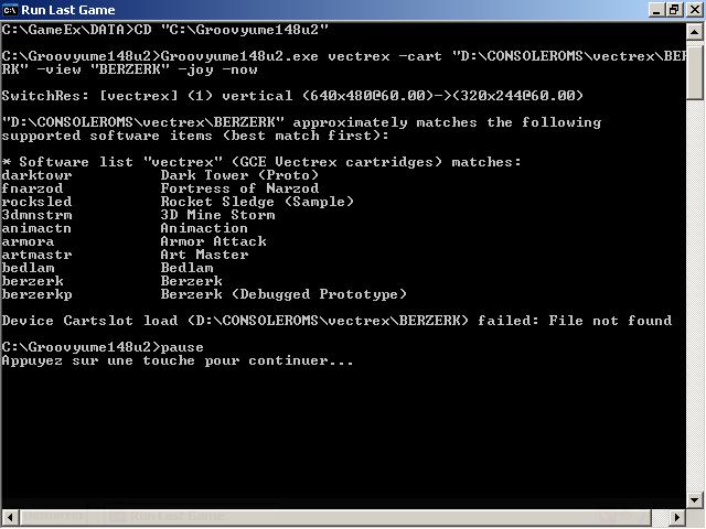

Anyway I have used the RunitGame.bat command and here are the outcomes in the screenshot.
I do not understand why Mess is using a software list to launch a game? I never set this....

Hi repetto,
I've never used MESS myself, but if it is at all like MAME then your romset will need to be named to match the version of MESS you are using. The reason it is spewing you that list it because it doesn't recognise "BERZERK" as a valid rom, therefore it shows you a list of what you might be trying to load. As you can see "berzerk" is there as a valid entry. Unfortunately as yours is capitalised it is just as unrecognisable as if it was called "IAMNOTAVALIDROM".
Is your romset the same version as your MESS? For example if you're using MESS 0.150 then you will need version 0.150 of the romset. If you are sure this is the case then you can use a rom manager such as RomCenter to rename your roms.
If you want to test it, just rename "BERZERK" to "berzerk" and try launching again. If it works then you will need to rename your whole set.
EDIT - i see you say it works through MessUI? Hmmm ok, you have double checked your paths? If so could you humor me and still try renaming BERZERK as mentioned?
