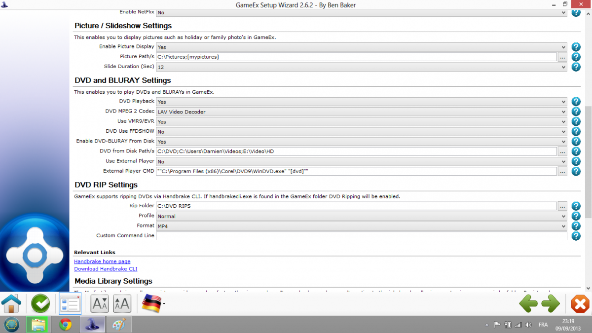

Vacheatuba Posted September 9, 2013 Author Share Posted September 9, 2013 I found :Install the CCCP pack codec. (Shark codec give me black screen)And set Gameex as the picture attachedThanks for your help and the way you give me to fix this issue.You coud close this post Link to comment Share on other sites More sharing options...
