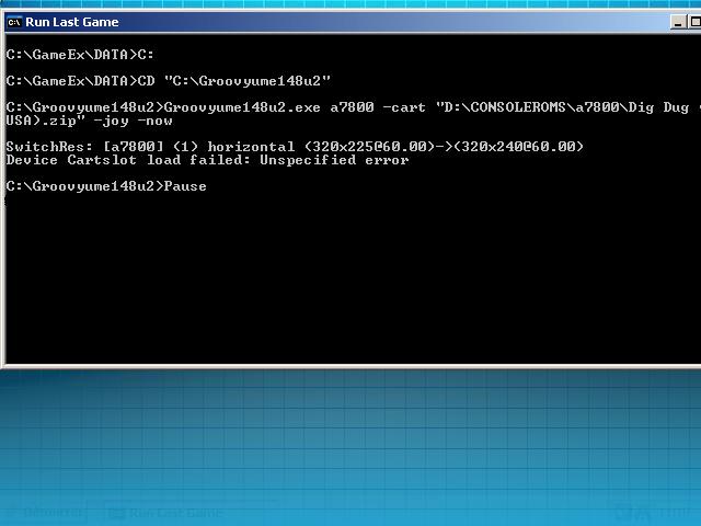

repetto74 Posted May 27, 2013 Posted May 27, 2013 Hi,I have exactly the same problem with Mess 0.148 (it is the GroovyUME built) and emulation of the Atari 7800. I have already configured successfully the Atari 2600 and 5200. Assuming that settings and logic for the Atari 7800 emu should be the same, I end up with a black screen and then back to GE.I ran the Lastgame batch and have the same issue. I have enclosed a print screen of the batch window.I am using the No Intro romset (roms are zipped and in the .a78 format). Thanks
repetto74 Posted May 27, 2013 Posted May 27, 2013 I may remember having already tried to run a rom unzipped but same result.Maybe I will try with another romset.
repetto74 Posted May 28, 2013 Posted May 28, 2013 (edited) Ok solved now.I tried a Goodset for the 7800 and now it is working. Do not know why the No Intro set is giving troubles.... Edited May 28, 2013 by Tempest See forum rules about roms
fRequEnCy Posted May 28, 2013 Posted May 28, 2013 Ok solved now.I tried a Goodset for the 7800 and now it is working. Do not know why the No Intro set is giving troubles.... Probably has to do with the headers of that romset. Also watch your wording of how roms are obtained.
