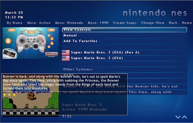

I setup a temporary NES emulator using the exact settings you provided. I think I realize why I thought it wasn't working. It filters through everything properly at a game level but not at a system level. Hopefully this isn't something just on my end again.
Here's some screens to better explain.
At a game level I only see the USA versions of Super Mario 3 - works as intended.
At the system level I still see plenty of European/Japanese games. (Super Mario + Tetris, Super Mario USA, Super Mogura, Super Momotaru, Super Pang, etc)

Whoa! Yes I can duplicate the behavior you describe here. What's funny is that if you open up one of the European or Japanese games from the main list there are no playable games listed within the merged set (where the set consists of only that one game). Seems to me like you've uncovered a minor bug in the system. It would probably be worth elevating this to Tom's attention, or at least documenting it as a feature request.
