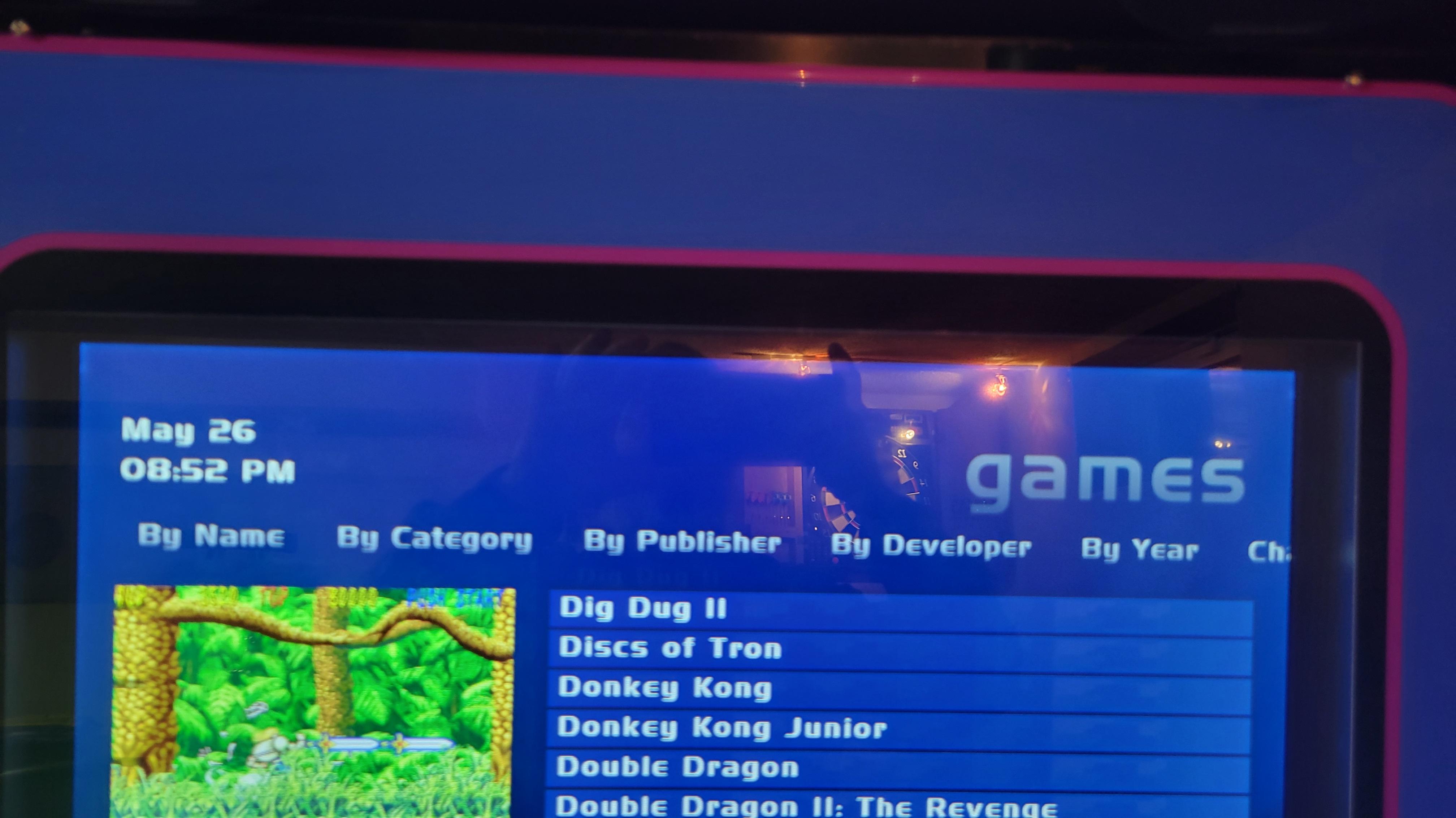

It running but it looks horrible now!!! How do i get the scroll wheel on the right back?
How do I get rid of the clock?
The labels in gameex?
Wow it doesnt even look like a frontwnd any more..it looks like a windows  desktop !!
Please help me get it back to looking like an arcade again.

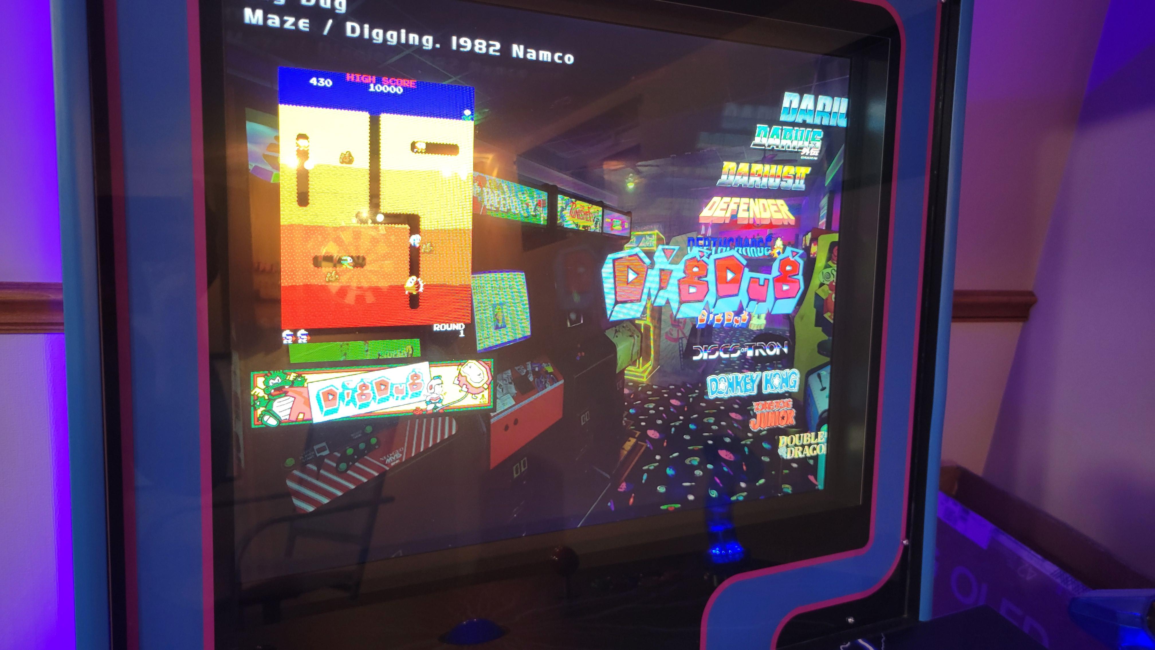

ok. Sorry. I appreciate the help. With all the new changes i am seeing on Gameex I'm now lost. It looks like your basic run of the mill media center.  A year ago I had gameex running MAME with the arcade video running in the background with  snapshots on the left with a vertical scroll wheel on the right displaying mame game logos.
no labels anywhere.. no clocks...just games and associated images. 1 button to select a game and 1 to exit out of the current game. Can you help me navigate to reclaim this?

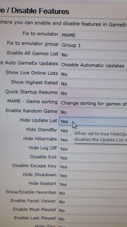

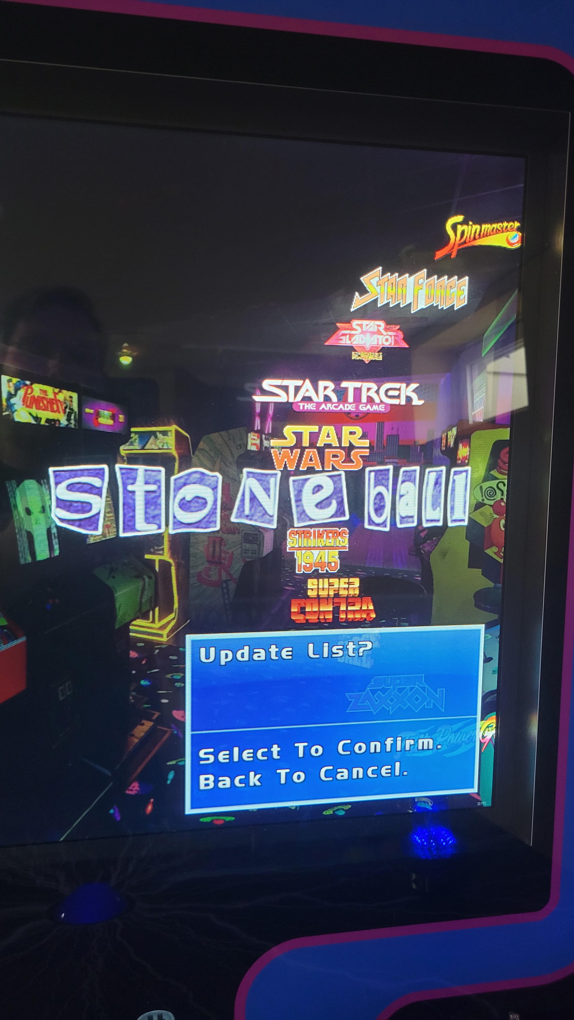

So I have 2 small issues that I can't figure out.... first I can't stop the  update roms from displaying when I first run AE.  In the setup wizard  hide update list is set to yes.

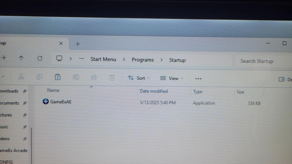

 The second is when I set gameexae in the startup folder it doesnt auto run when I reboot. Suggestions??
Are you referring to where it scans emulators and databases at startup or are you stuck in a mame update list loop? Can you post another log please?
As for startup, what i normally do is drag the shortcut in the start menu to "startup". Does that work for you?
oh sorry. you need to create a shortcut first then drag the shortcut.
Pressing backspace will normally disable that. if not just let it update once. Is it stuck in a loop? Is there an issue in doing that? it does that when it detects a new MAME version. it looks like that is the case looking at your first log.
The setting you are referring to hides the option from the menu.
